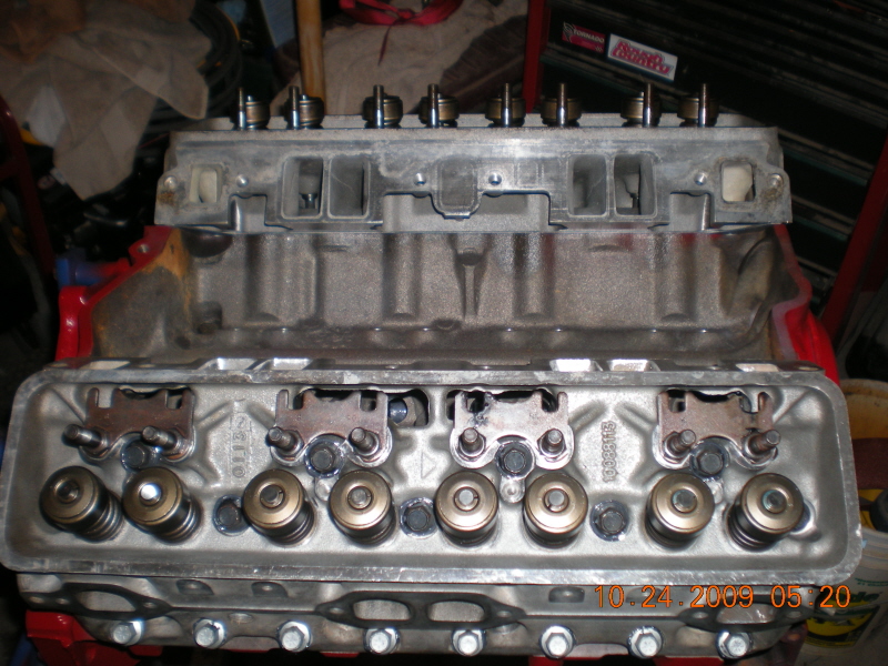

I'm building a 383 for my 23' wellcraft I tend to take it easy on my stuff, I like to run without breaking if I can. I know lots of people with big fast boats so I'm tempted to keep up every now and then.

What cam are you running and what heads are on there? I ran a RPM intake with a JET mod'd merc QJet and pull 436 Hp on the dyno. If you want to run a Qjet that is setup well for the 383 power curve in a boat let me know, I want to get rid of it. I have a pro systems carb on a single plane intake now, pulling just under 500hp.
