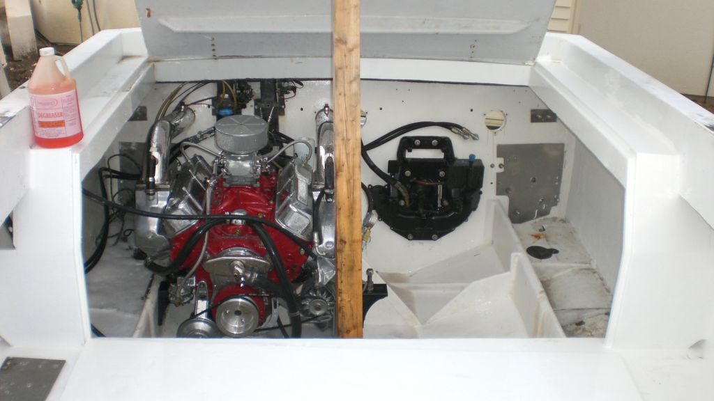

I have an old project that I've been redesigning to suit my taste. Hopefully this winter I can get some new foam/vinyl. What I'm looking for here is structural tips and features that can be easily implemented now.
Keep in mind, I'm not doing this to increase resale value. I actually enjoy the process of rebuilding a boat.
One of the first mods I made was combining the hatch with the back rest. I hated more than anything not having easy access to the bilge. Now I will be able to clean the sea strainers without having to stand on my head. I was a little worried about structural integrity but when I put in the supports to the floor and side it's just as strong.

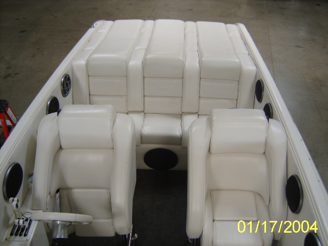

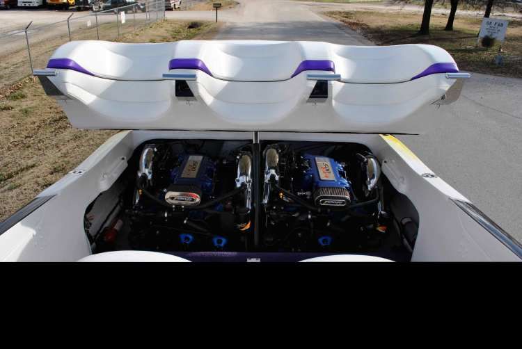

What I would like to do with this is have the sunpad/backrest combined like these boats. The two with molded seats might be a little too much to ask from a local marine upholsterer. The one with all the speakers looks a little too busy for me, but you get the idea.
I'm wondering if I can have the foam/vinyl made directly to the hatch? I really don't want to use wood behind the foam if I can avoid it.
One thing I'm worried about with this is the way the hatch is hinged. It will pinch the pad when the hatch is opened.
Car hood style hinges, would make it swing up nd slightly away removing the pinch.
