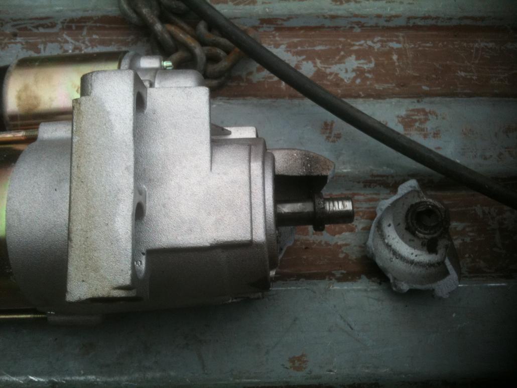

Another idea I was thinking of is I have had a starter turn over slow and then speed up when engine is warm and or when the timing is advanced to far.
Timing is set at 34 degrees. The other motor is also set at 34 degrees with no problems.
It almost acts like the motor spins over hard when it grinds and the starter has enough torque to spin faster than the motor turns and eventually breaks the housing.
Any ideas on this one?
Do you still have the Thunderbolt Dist or do you have something else installed ?
There are a couple of things that will do that to the drive end housing.
One, kick back against timing
Two, incorrect drive gear to flywheel tooth depth ( shimming)
Three, too long a bolt ( loose starter moves)
Four, wrong housing ( Imperial 3/8 holes and 10mm bolts)
If you are not running the timing locked at full advance, I suspect your dealing with issue number two.
When everything heats up, particularilty after a hot soak, the teeth grow, the housing grows, the ring gear grows and IF you did have any clearance on a cold motor, it is now gone and the flywheel will wipe out drive end housings one after the other.
The gears crush together with no space between the teeth. This causes hard engagement ( grind when key turned) and once the engine fires, the initial force of the flywheel against the starter drive literally pushes the drive sideways away from the flywheel and breaks the drive end housing.
Use liquid paper to paint the drive teeth completely. Install the starter using one shim. Crank the motor a few times and then pull the starter and inspect the wera pattern on the drive. If the liquid paper has been removed right down to the bottom of the teeth, add another shim and retest.
