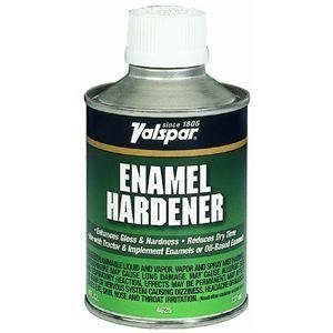

Rustoleum and a can of this stuff to make it harden up in about 15 minutes.
