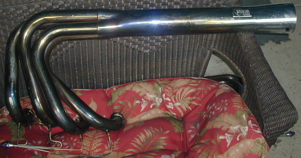

If someone had the skill to weld and bend tubing very well and unlimited free time and materials they could build there own water jackets over a set of car headers but it would look like crap and they wouldn't last very long as the steel is very thin, I could think of better ways to spend my time but just saying.
I have seen BBC and BBF hooker boat headers , they were for jet boats/v-drives, water injected and come with a warning not to enclose them. I remember hearing in the day that there were no insurance company's that would insure jet boats and drives with "over the transom headers" as they were/are very dangerous to passengers , Smitty
