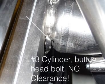

The port side header is on. A quick look at the pictures tells the story.
Cap/Socket bolts would not work. Not even close. The diameter of the head is about the same size as the "washer" part of the 12-point, which is too big. The height of the head is too tall. They take a 5/16 allen wrench, which wouldn't clear the header.
12-point ARP Header bolt is so far from working, it is a joke. The head is too tall, and even with grinding off 30% of the upper shoulder, 3 of the 6 bolts wouldn't allow a wrench to get between the bolt and header.
Stud with bolts is even more out of the picture. The height and diameter of a nut to fit the 3/8" X 16 stud is so big you can even get it started on top of the stud, much less turn it, as it is hitting the header pipe.
Button head bolt was the only thing that was even close to working, and even then I had to grind off a side of the two center bolts to get them into the hole. Look at the clearance between the low profile button head and the header pipe. It is virtually non-existant. So much so, that even though they take a relatively small 7/32" Allen wrench, on the center two bolts, I could barely get the ball end allen wrench in/out of the head because it was hitting the header pipe.
And, I have a serious concern that I can put enough torque on the bolts using a 7/32" BALL allen wrench, as they are even weaker because they are thinned to create the ball. And if you broke off the end of the allen wrench, you would be completely screwed. In that tight space, I can't image you could ever get it out of the socket, or remove the bolt without destroying the headers.
I'm also sending this information to CMI, as I'm pretty convinced that this product shouldn't be sold in it's current configuration. It is impossible to install correctly.

So far, CMI's solution is to send shouldered hex head header bolts. They say the headers were designed to be used with this bolt configuration. Designed for them? Yes. Built to design? I'll let the pictures speak for themselves.
The shank of the ABUS lock is exactly 1/4" thick.
The 12-point head is 1/16 short of 3/8" tall.
The cap head is 1/32" MORE than 3/8" tall.
The button cap head is only 5/16" tall.
I don't believe these headers are built correctly. The clearance for a bolt on the outer pipes is workable. The clearance for a bolt of any kind on the inner two pipes is unusable. The water jacket pipe should have been welded onto the header pipe farther out, away from the base. Just my 2¢. But then, I'm not an engineer.

The adapter plate was so drilled/tapped/threaded, with another set of holes that matched up with a more offset mounting bolt location that was away from the header pipe, to avoid the very thing I'm fighting with. It was an awesome design and worked great. I have no idea why these are not done the same way.
I didn't receive the Hex head header bolts today, probably tomorrow. If they bolts prove to be unusable, and I can't imagine how they could work, given the lack of height available, it will be time to have a real serious conversation with CMI.
I think the way they have dealt with this so far has been pretty pathetic, but I will give them one more chance to do the right thing, which would be take these back, and make me a set with adapter plates like the original used set I bought for the money I have spent on this exhaust and the spacer plates. And if they had any class, they would polish them at no extra charge for all the grief they have caused me.
