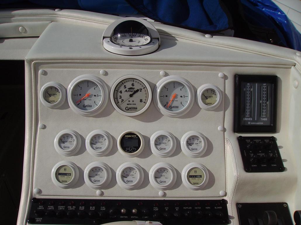

Mine has aircraft style toggles with start buttons. Obviously my kill switch still works so in the event something happened to me and a passenger couldn't figure out how to flip the toggles to kill the engine they could pull the kill lanyard which will kill both engines.
I like the toggles, and push button. It is also nice not having to worry about losing keys.
