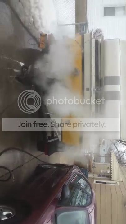

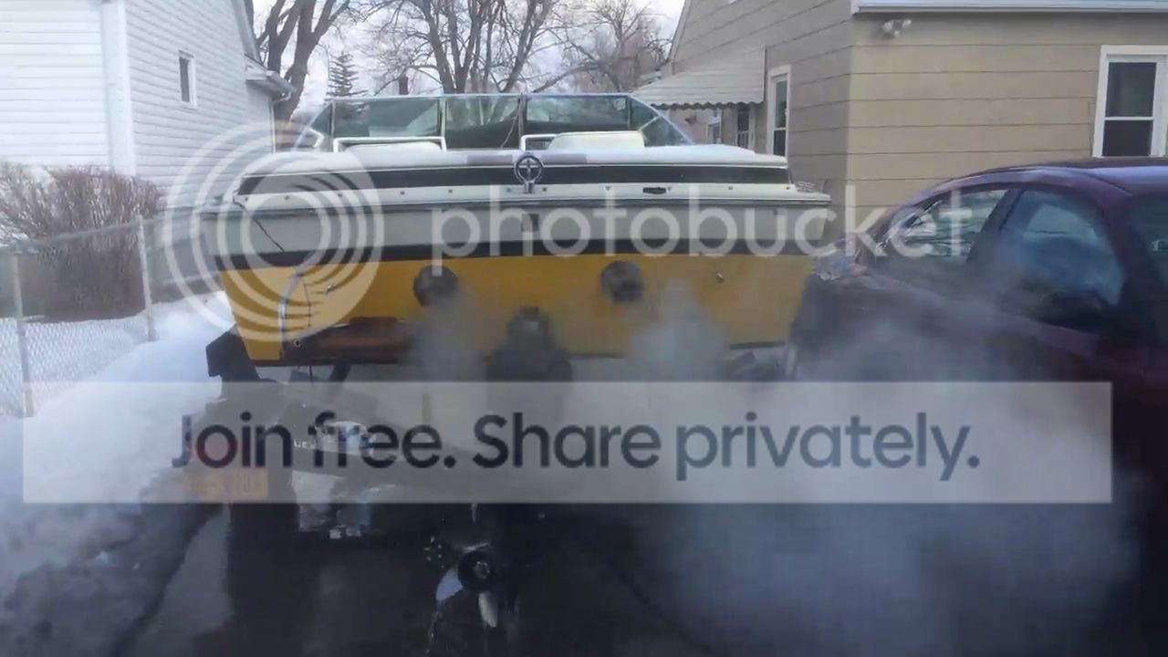

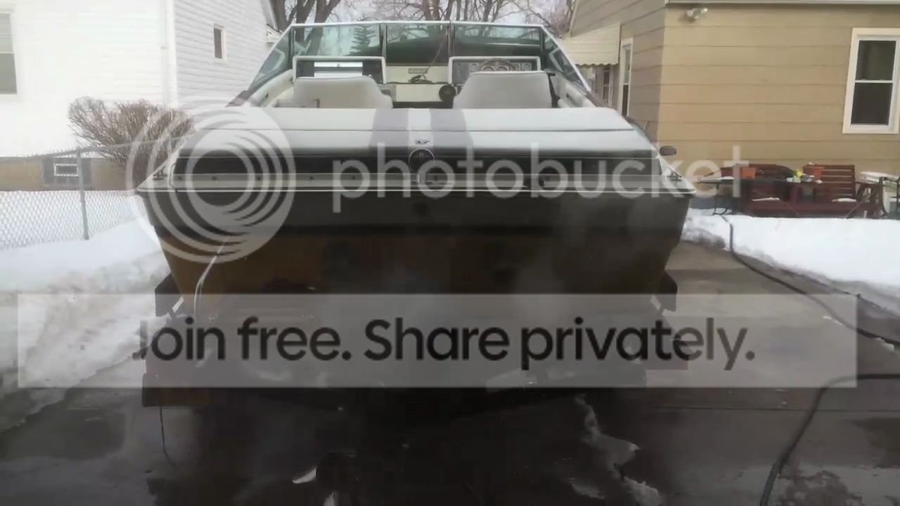

I built a 355. Flat top pistons, vortec heads, comp 262 xtreme marine flat cam, RPM air gap intake, GLM manifolds. I put on a Sea Demon 750 double pumper and new ignition. I am not quite happy with my tuning.
The first video is 12 degrees at idle, 32 all in. The carb had the idle set at 800 with the mixture screws about 1 1/4 out.
the next one is same timing but I played with the idle eaz and mix screws more. It Idled at 1000-1100. I felt it was too high but ran the best.
The last video ran at 750-800 but didnt sound as healty.
This is the first motor I have ever worked on that was carbed and not computer controlled. What do you guys think?
