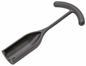

You will get there. I have at least 2 or 3 spark plug boot pullers, but have never had much luck with them.
I did just pick this one up on a whim from Harbor Freight a few weeks ago, but have not tried it:
[ATTACH=CONFIG]524114[/ATTACH]
Try a totally different approach. Lay across the top of the engines as described in the other thread.
It used to take me 2 hours per motor. 1 hour for 7 plugs. And a second hour farking around with that last one; rear most, port side.
Climbing down the gunwale on the port motor helps (which I can do on my boat).
Laying across the motors for the starboard motor helps.
Get rid of the hatch. Stand it straight up, and suspend it from a rafter (indoors) or a tree (outdoors). This alone saved me at least an 60-90 minutes getting better access.
It CAN be done. I've done it, twice on each motor. Again, find a totally different angle than you have been trying so far.
