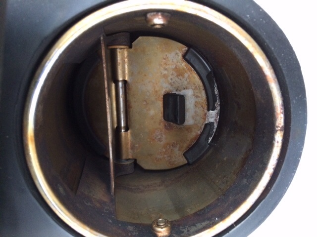

My 32 Fountain fever has the external ugly "salisbury" style exhaust tip flappers on 4" exhaust tips that are OE. My engines are stock 502 EFI and I have "silent choice".
I decided to have a peek up inside the exhaust pipes and this is what I found inside three of them:
Obviously the internal "rubber flapper" is missing from the rod in this pic. Three of my exhaust pipes are this way...
The fouth one looks like this and is missing half of the flapper:
My question is what should I do for a replacement? I understand these "burn out" somewhat frequently? I do not like the idea of ripping the exhaust apart all the time for their replacement if it's just going to happen again. I saw these Hardin units on CP's website that look interesting and was wondering if anyone had any experience with them? They look to be heavier duty, easy to install, do not require any welding and have serviceable parts should there be a problem:

I have a very easy solution for you.
[ATTACH=CONFIG]536850[/ATTACH]
It is a stainless flapper carriage. It is an insert that installs from the outside and slides inside the exhaust tip and then screws to the side of the exhaust tip. All you need to do is drill two small holes in the tip. I have them on my boat.
Now the only problem is that Dana Marine was the only company that made them and they're out of business but you're in luck. I just got brand new dry tailpipes and I can no longer use these on my back two engines, so I would sell you four of them for $200 plus the ride.. PM me if you're interested...
PS. this is a picture of an old one before I replaced them last year. The ones I have on the boat are in much better shape. If you are interested, I will take one out of the exhaust tip and take some better pictures..

There is a rubber flap fastened to a steel hinge that lets the flapper open and close. That hinge bangs against the assembly its connected to. Any flapper thats inside the pipe is going to make some noise. Can't see how you can avoid it and still make something that will survive. They're advertised as "silent", I don't think thats true.
