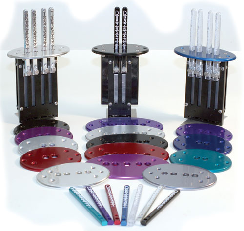

How about trim sticks? The Mercruiser sending units never held up for me in the past. Mechanical is set it and forget it.
http://underdogracing.com/
murfman is offline

Why not do something like this??
http://www.cpperformance.com/p-14402...ndicators.aspx
ALL_IN! is offline
