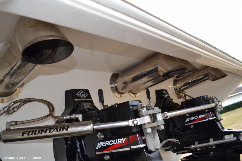

Haven't had much luck finding a good pic of a 1990 factory ext steering.
Found a pic of the 2003 Fountain wing plate. Looks like it only uses the 3 back cover attachment points.
Any known issues with this wing plate set-up? The plate looks plenty strong, but it's the only set-up I've seen that only uses 3 attachment points. My boat runs in the low 80's and only used in fresh water.
