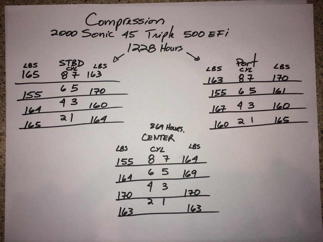

[ATTACH=CONFIG]559959[/ATTACH]3 hours of fun finally gave me my 24 compression tes numbers! Quite happy with the result honestly!
1228 hours original hours, took off all 8 spark plug in each engines, on cold engines by the way, and turned 5 times
Check pictures for readings!
