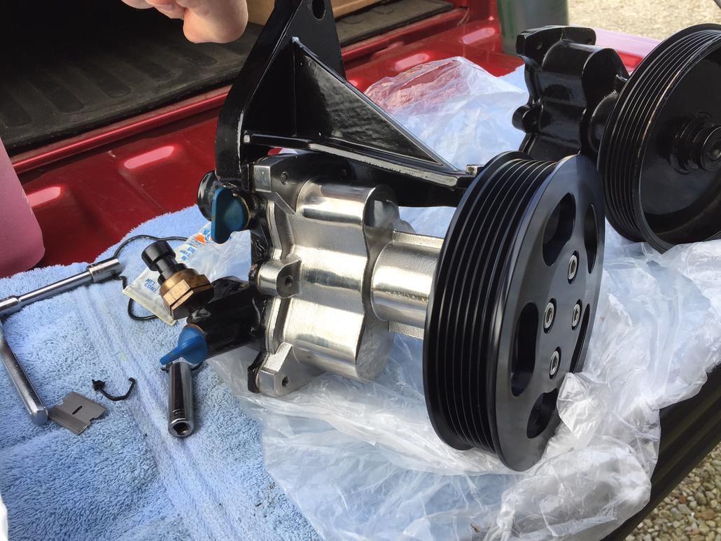

I recently went the Hardin route. Very, very nice piece. Very, very pricey piece! I got 10 bucks off by entering "save10off100" in the promo code field at checkout. See if that still works. Every little bit helps.

Was trying to stay away from drilling but since I'm in fresh and just installed a lift, the holes shouldn't be that much of a corrosion issue any longer. Do like the looks of it as well
Thanks for the tip, it might help, and I would love to have that much room to work in.
