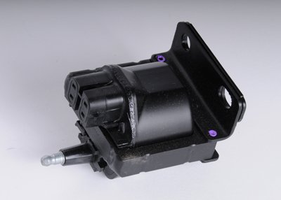

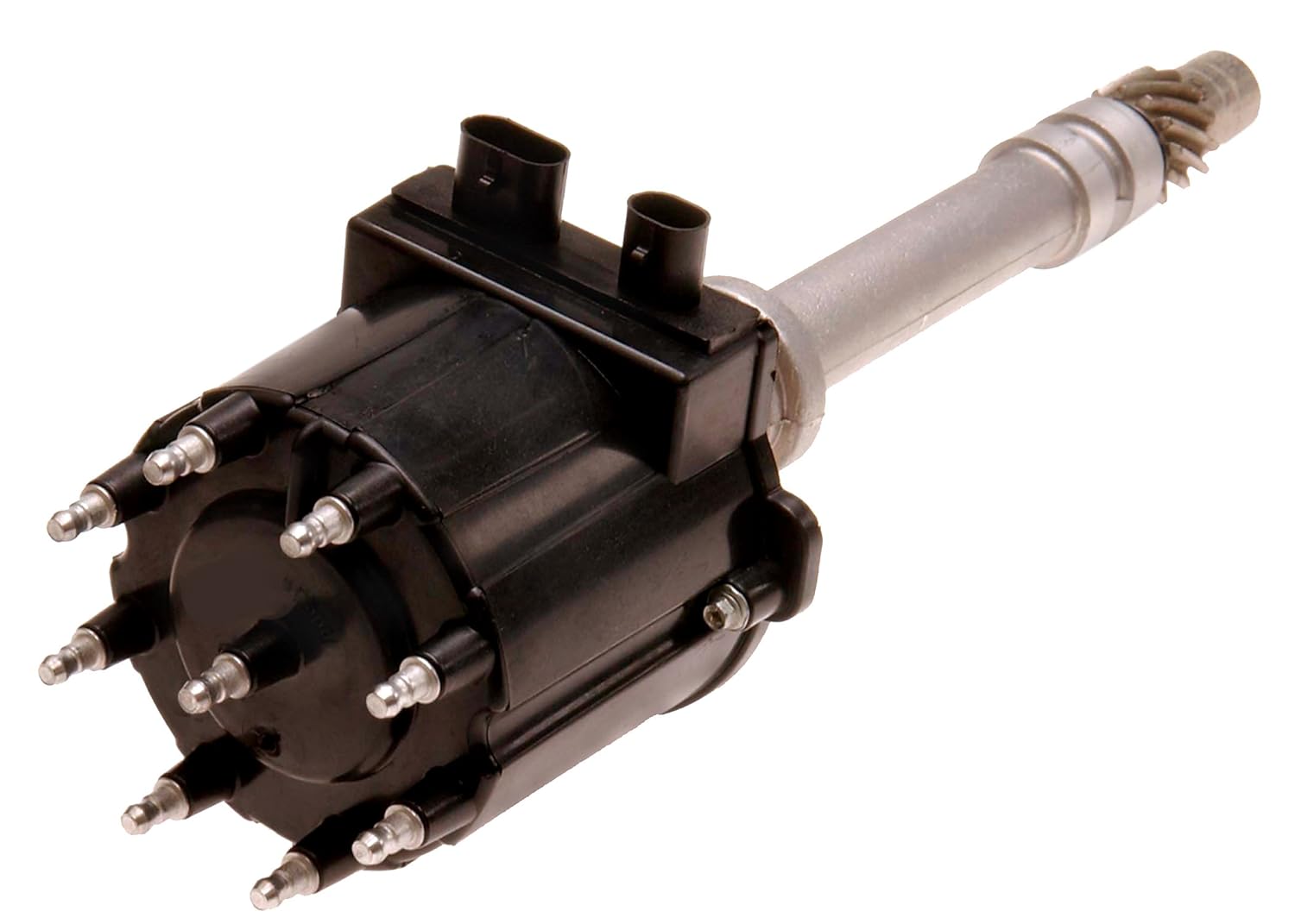

The external coil GM all electronic HEI distributor and coil are used on the Mercruiser 502MPI engines + many of their other fuel injected engines. They can be found around $180 -$190 new. I believe ACDelco's # is 1104060. Double check. $184.00 Amazon Prime - note I believe a 1-2 week backorder. The coil for this is ACDelco D560 GM Original Equipment Ignition Coil ($59.92 Amzaon Prime) and comes with the bracket.
If you have the 502MPI wiring harness, then is all a no brainer.

Ok, that number comes up as pass car distributor. Is there any functional or LEGAL diff between auto and marine hei distributors? I run auto stuff, but every time I suggest it people start screaming. Merc's number is 805222a. 600 bucks. I think the only diff is that shiny black paint. It seems to triple the price of everything.
dereknkathy is offline
Old 06-21-2017 | 08:35 AM
SB
Joined: Nov 2004
Posts: 14,111
Likes: 3,695
From: On A Dirt Floor
No. The external coil HEI Merc distributor is the auto distributor with no modifications. Bonus !
