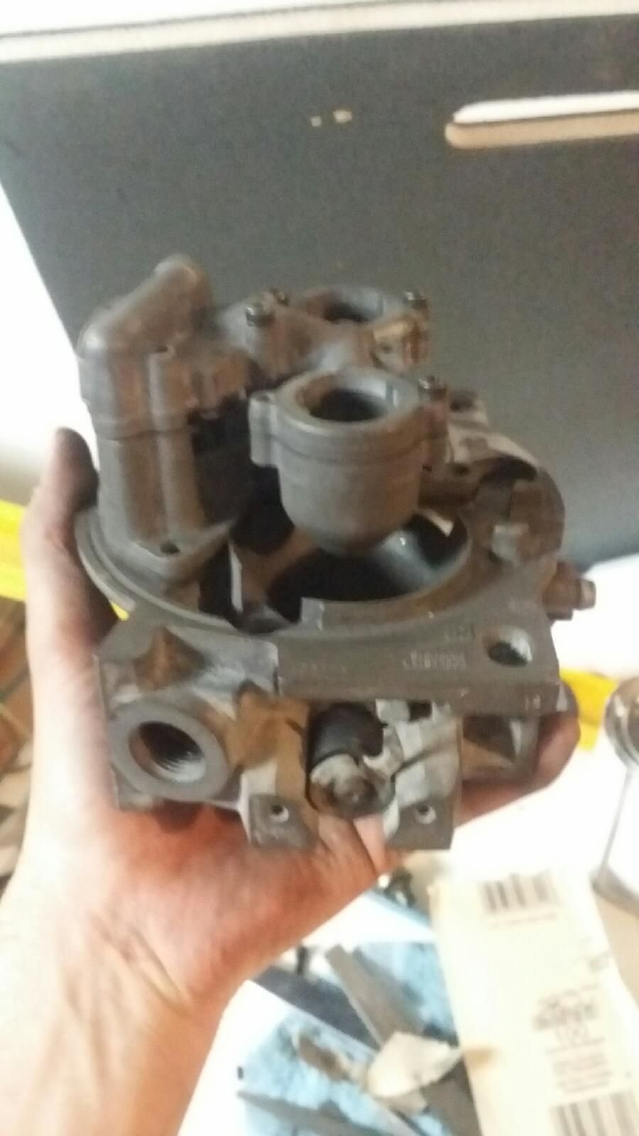

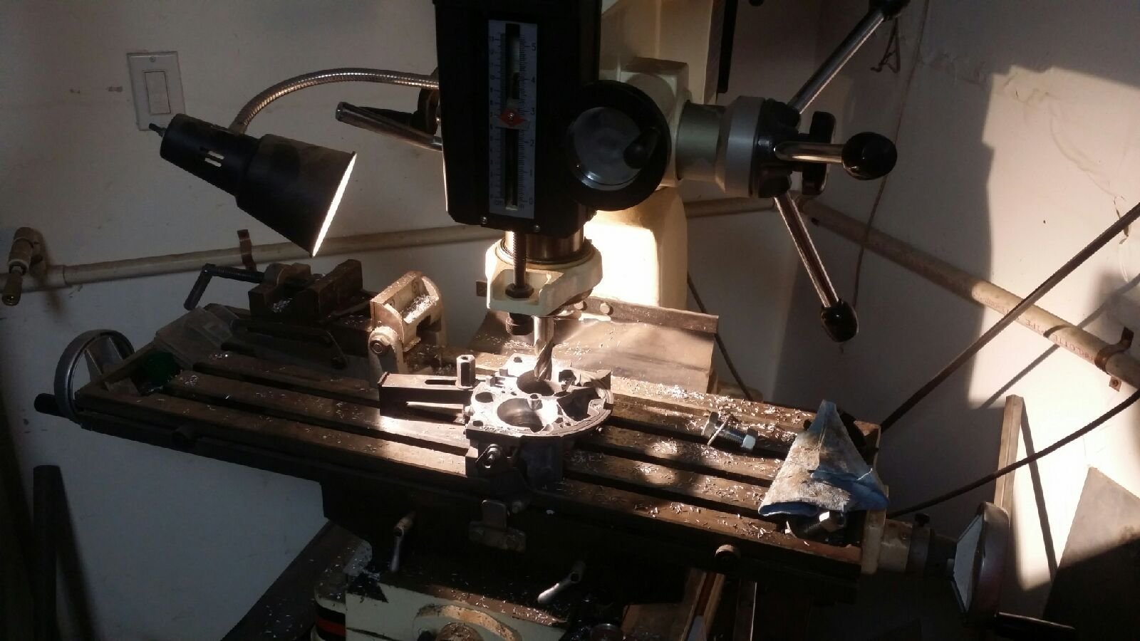

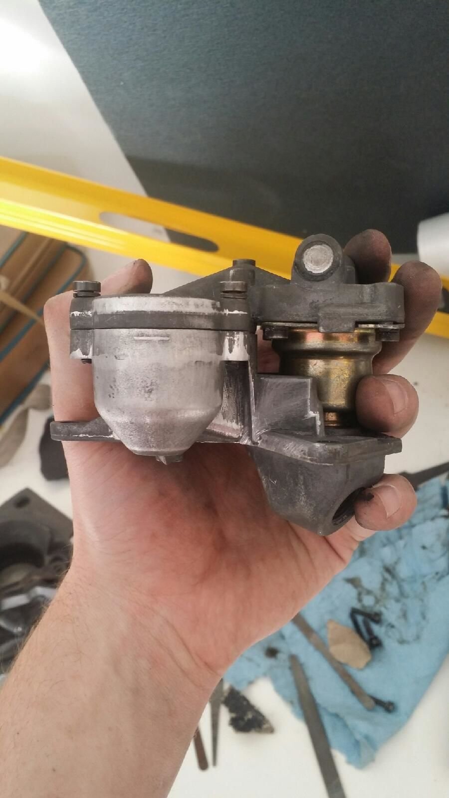

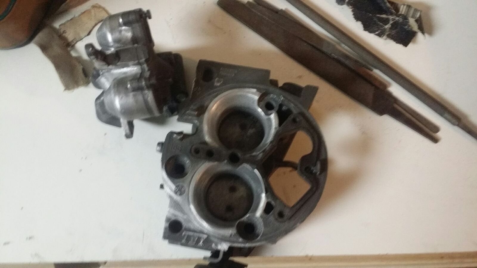

The stock unit off of a chevy 350, injectors are 55LBs. I have milled off the top of the units. put a nice radius on all of the edges and cleaned it up so it "should" flow better than stock
Start
getting a good clean cut off.
removing all the casting flash and hard edges on the injector housing
after taking some hand files to the edges and sand paper
all done.
