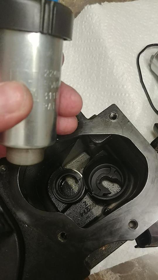

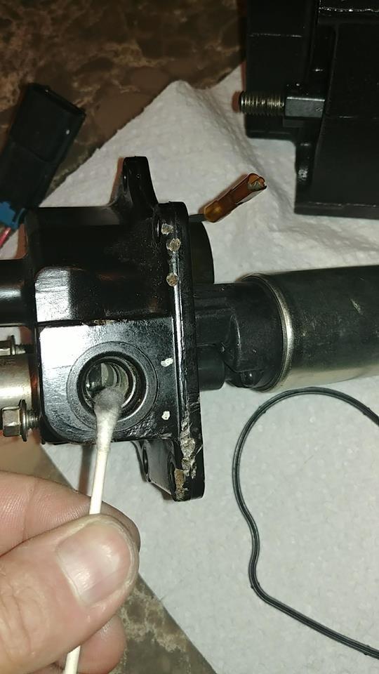

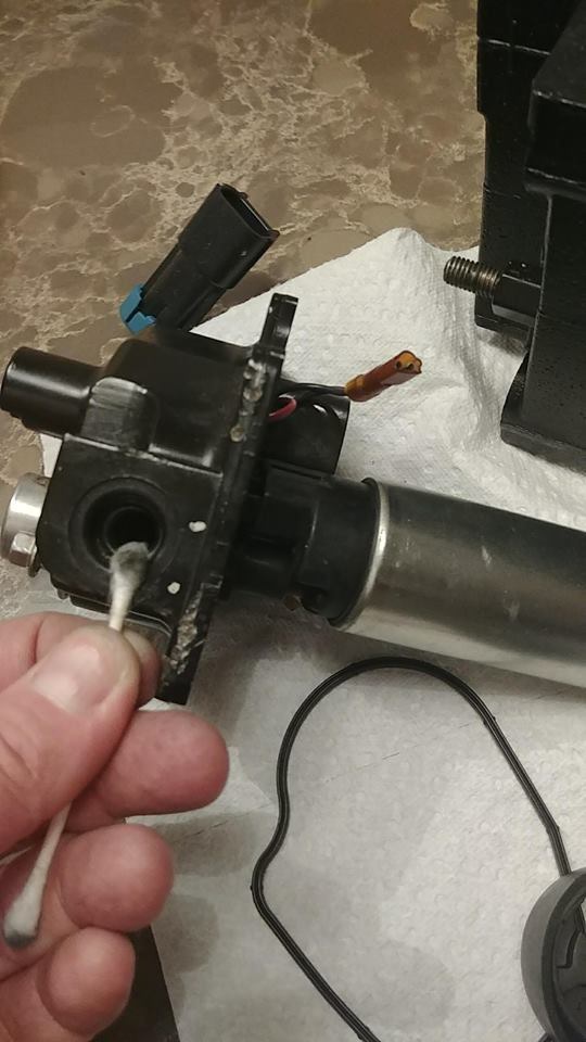

some pics
BUP is offline

In the pics -- that hole is the fuel outlet / fuel line. There is paint and some aluminum corrosion inside all the way as far as I can get in with q tips. The q tips have paint thinner on it. And my finger has paint flakes on it. Any of that paint or corrosion is on the way to the fuel injectors.
I cleaned the fuel injectors and ordered the new cool fuel as it does not have any internal paint plus drains water with front blue plug. The high pressure fuel pump had paint in it. - The injectors had paint in them as well. - the fuel pumps where half dead. Actually the internal paint issue is nothing new - very old news and has been around since the gen 3 cool fuel came out 13 years ago.
