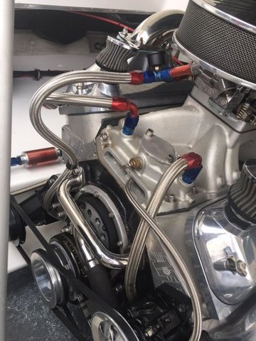

Maybe I got a head ofmyself for coolant temp or temp alarm sensors. On a Vic Jr intake manifold, there are three places one can use. Does your intake have these ?
Maybe a good idea to show pics of your intake manifold and thermostat housing so we can see and discuss.

As you can see those holes are already being utilized
Ayuh,...... So put a Tee where the gauge sender is, for both, or drill, 'n tap the t-stat cover for 1/2" pipe,.....
