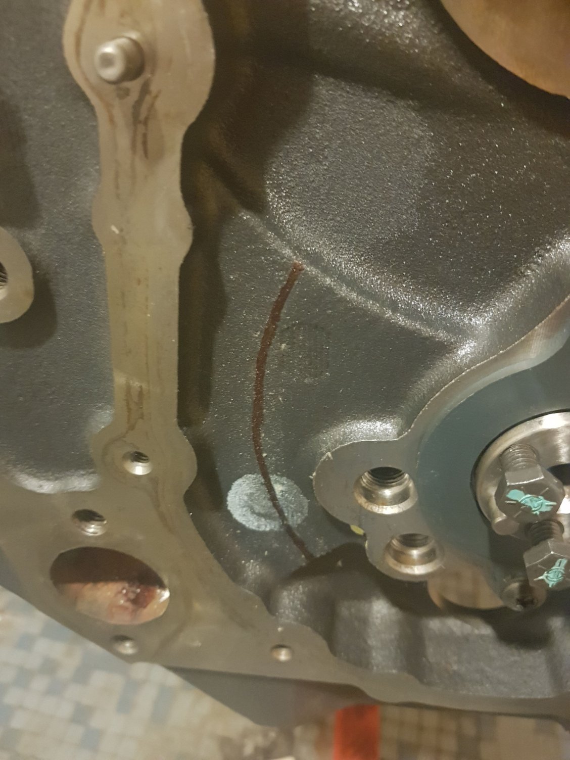

Comp cams 7101 timing set needs clearancing, the chain is rubbing the block next to cylinder number 1. Is there bolt on adjustable timing set for Gen 6, 502?
JaniH 01-08-2020 05:41 AM
https://cimg1.ibsrv.net/gimg/www.off...6d5d321be7.jpg
Did not feel or hear friction while degreeing the camshaft. how thick is the block where you see the marked line in the picture? Really hate start grinding the block. I guess all double chain kits will rub.
