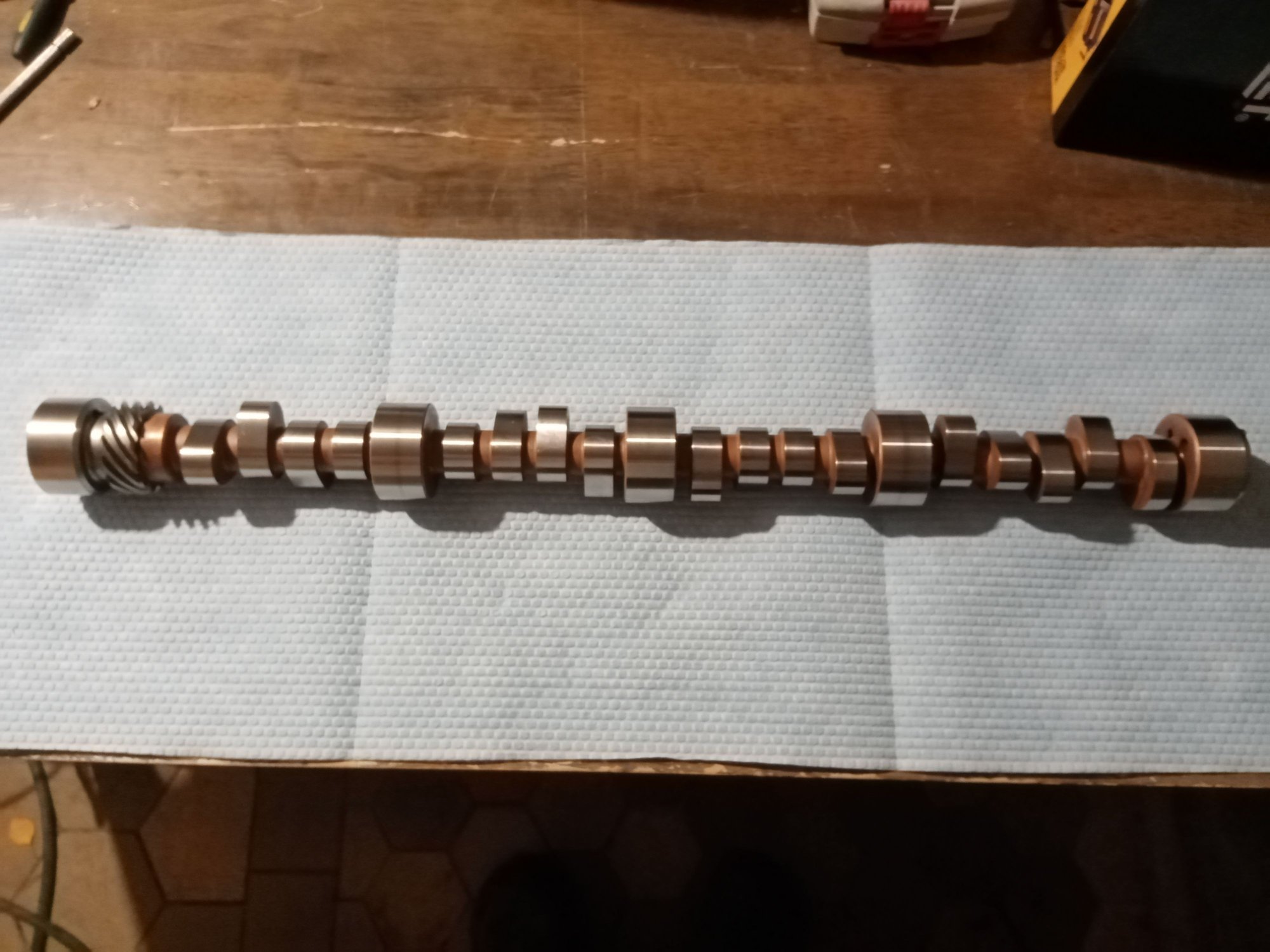

you'd have been better off w/ this cam than that abomination of a cam your getting. just saying.
https://www.lunatipower.com/efi-retr...k-289-299.html

i do believe with the cam you have, its gonna make some torque down low. Which sounds like what you asked for. One thing id be careful with, is detonation. Thats alot of conpression for a marine engine, esp with a small cam thats gonna get lugged around at 2500rpm like you want to. Id be very careful with my tuneup, and try to keep the engines water temp as cool as possible. I wouldnt even think of locking the timing out on it.
L19 rod bolts are silly in an engine that wont see north of 5200-5400rpm. Esp with a 4" stroke crank. Youll never be near the piston speed, or breaking point of even the standard 8740 bolts. Rpm is what kills rods. But you have them, so run them. Like Mike T said, dont change bolts unless you plan to have the rods resized.
Im not a fan of peanut ports. However, I think they do have their place in trucks and what not. The reality of it is though, you pay a price with them. For what they do down low, they give up on the big end. Today, a modern oval port, say like an AFR 265 or similar, wont give up anything to the peanuts down low, and blow them away up top. Can and have guys made them flow decent, yea. But no way would i ever spend that much time and money, putting big valves in them, tons of port work, then worry about hitting water ,etc. They just arent the heads you want if going fast is the goal. But speed doesnt seem like is what youre after, so, they should be fine. Most offshore guys here are looking for speed gains. And you dont gain speed in boat by adding low end torque. You gain speed by adding upper end torque (which is horsepower).

Chambers measured 122.5cc to 123cc, 1cc for bore notches, 0.5cc for piston to wall clearance above 1st piston ring,so should be right around 9.5. Valves are stock size 2.06"/1.72". Nice that you understand what i am after! cruising @2500rpm would be perfect. In theory, if i could spinn my 24" hydro p5x to 5000rpm with 1.5 gear ratio, 14% slip, that would be 65mph. Old 5500lbs 260 stinger is not fast hull anyway. The porting done to these heads is minimal. the valve unshrouding done to the chambers did hurt high lift flow quit a bit, and dont recomend it unless going with bigger valves, but like you said there is no sense anyway. I just hate when people say these 360 castings found from stock 454 330hp engines are useless, 15min bowl cleaning and short turn reshape stock valves/seats and they are in 260cfm range with very nice low lift flow. I have way too much displacement for these heads, that is sure. intake port csa is around 2.3sq" ,hopefully the engine peaks near 5000rpm, that we will find out later.

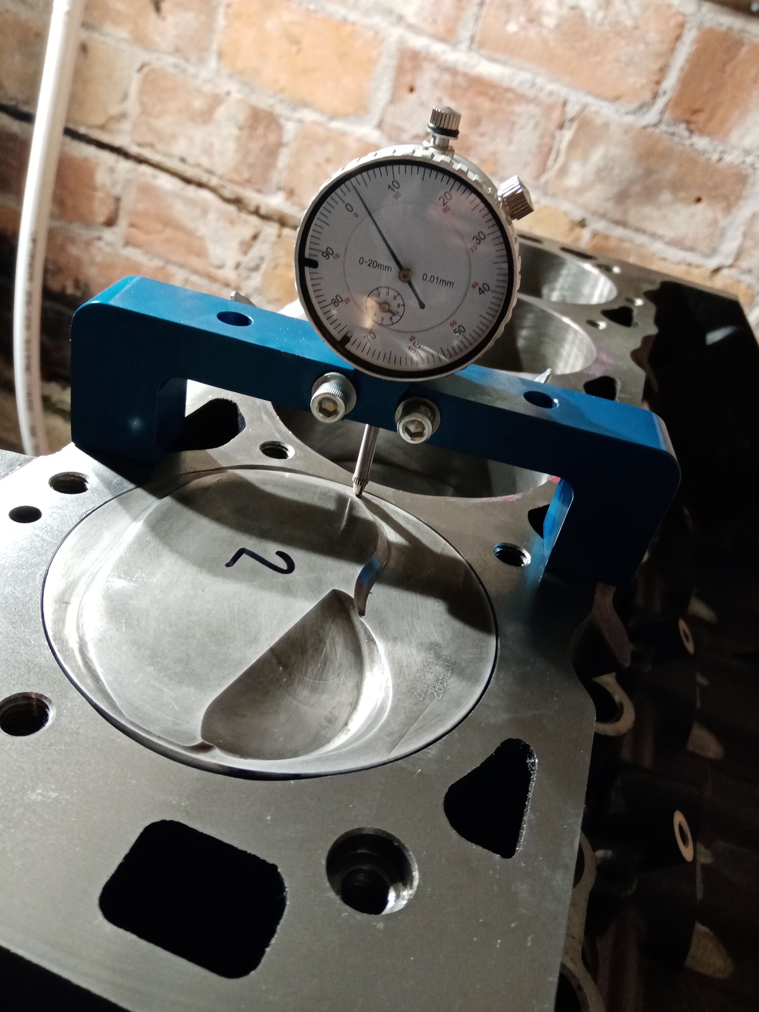

Pistons are In and approx 0.0014" above the deck, so with 0.039" gasket the quench should be around 0.0376". Connection rod side clearance 0.027".

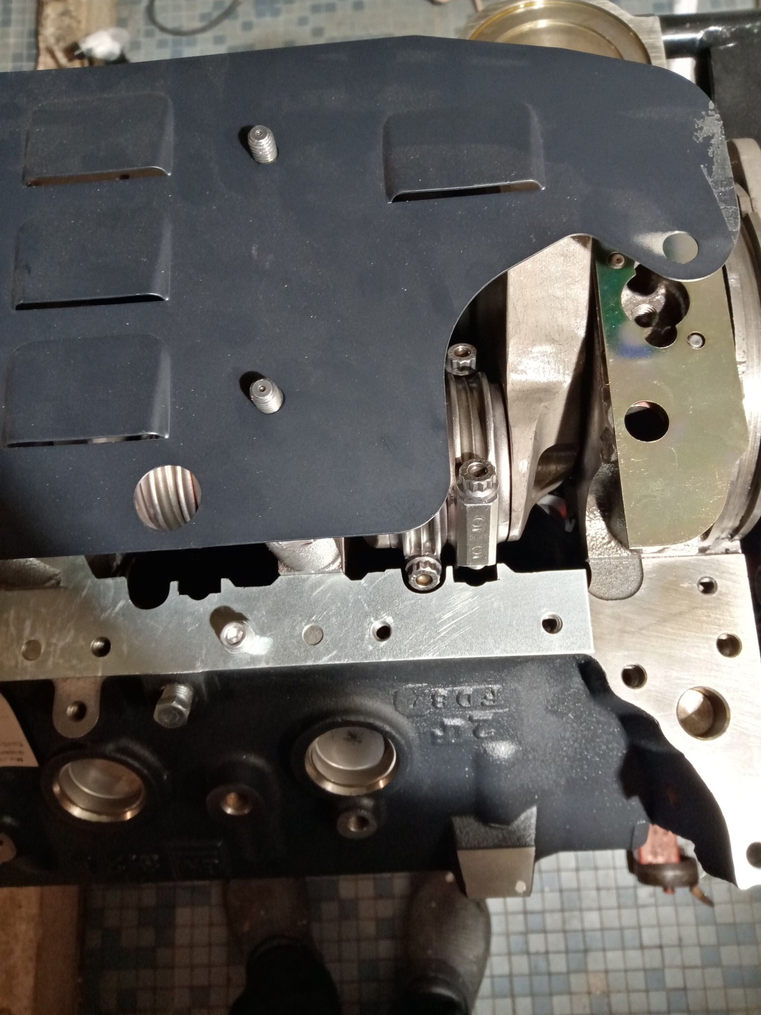

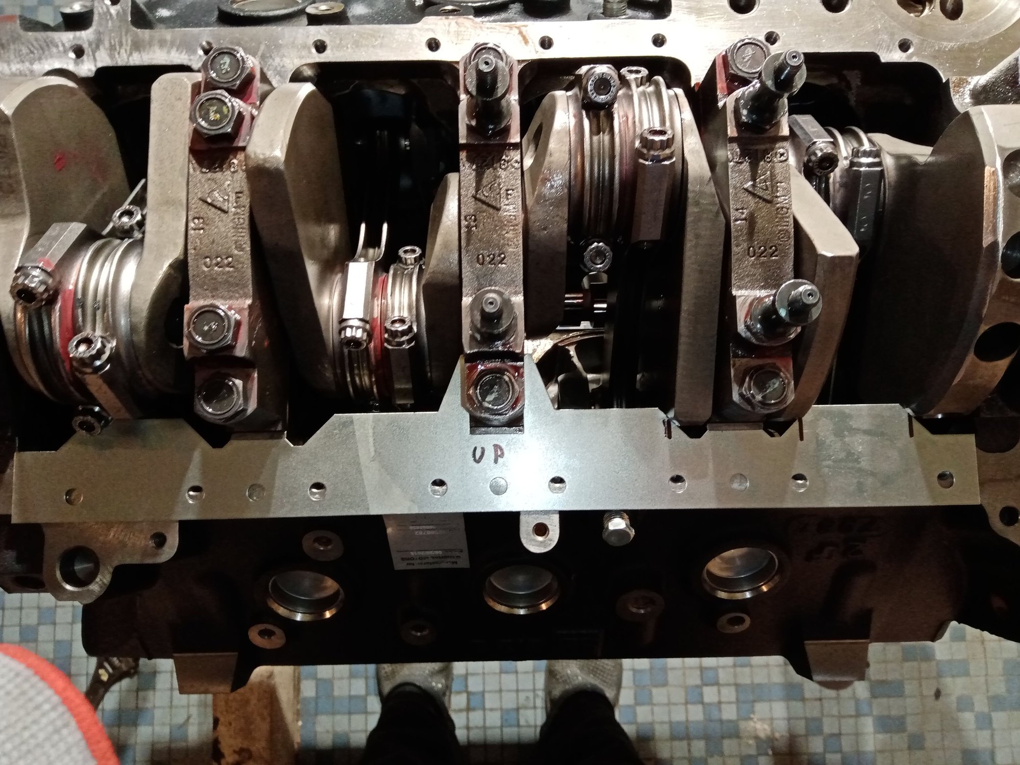

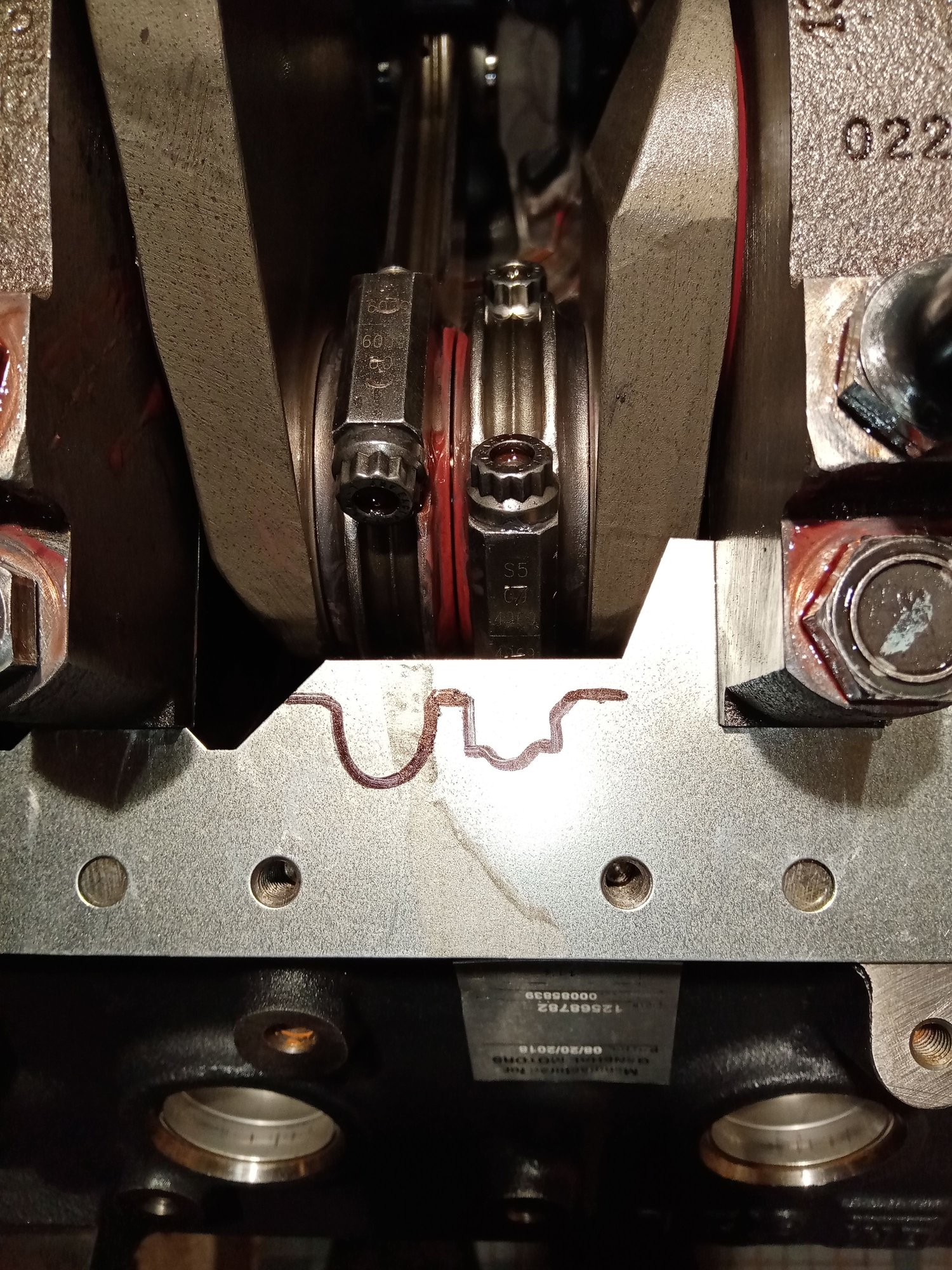

Bought the moroso oil control kit. Definetly not a bolt on stuff. Scraper is set for 0.040" clearance.

mike tkach 01-04-2021 08:07 AM
are those steel freeze
plugs?
