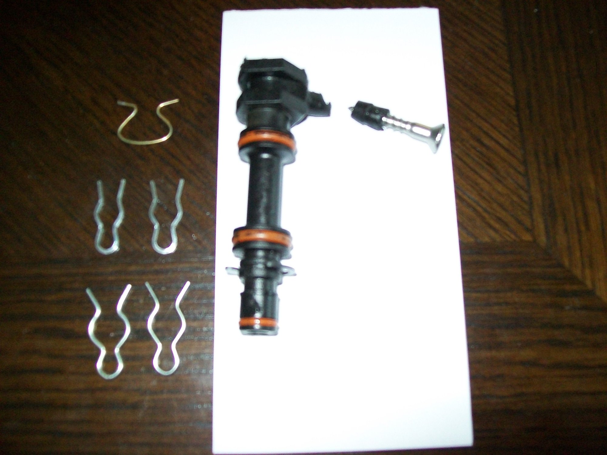

2 second clip job for the gear oil valve connection coming thru the transom.The one that breaks or cracks and leaks gear oil all over the place. The heck with the small C clip, These are so easy to install and remove can do it with my eyes close. You will thank me for this especially when it comes time to change out this junk fitting. I have done in the hundreds this way. No issues. And a screw to pull out the broken plastic fitting stuck in the oil line / hose that was cause your gear oil leak to begin with. You can thank me now I promise haha

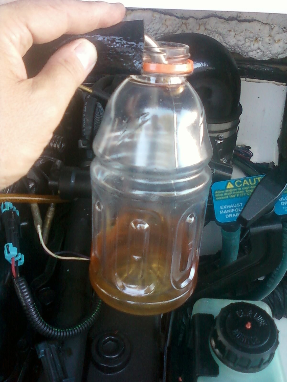

part 1 -- carb dry as bone no fuel at all in the carb. No start period - We have fuel right to the carb but again the carb is dry as a bone and no fuel pumping into the carb. We have fuel right at the carb thou - old fuel yes but again none in the carb Easy fix ??/ Yes indeed

^^^^^^^ Stock Merc TKS 2 bbl carb what was the problem above ??? Easy fix

^^^^^^ surely I did not stump the band here ? Offering a diagnostic tip / trick here. One tip -- does your fuel pump pump fuel test - yes it does ( in the pic) key on crank motor over - fuel flowed in the jug. We have fuel flow to the carb.
2, BUT the carb is dry as bone even with fuel flowing ?
