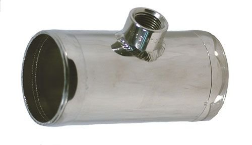

Thanks for the info. I think I’m going to go with the Sniper, im
getting Stainless Marine manifolds and risers and will have a bung put in to take care of the O2 sensor, now just have to figure out adding a fuel return since the VP MPI didn’t use one

You can run the regulator bypass return to the water separator filter head if you have a port available -6an

^^^Yup^^^
Or, if rather go back to the tank:
https://www.cpperformance.com/c-500-...s-returns.aspx

I had seen that T for the fill neck earlier while looking around for options and was going to ask if anyone had tried that or if it was a frowned upon option. Same with routing it to the filter, does that seem to work fine as well? What about fuel lines, what seems to be the best, approved route with those?

That T return works well , the inlet filter deal works good also for what you are doing.
