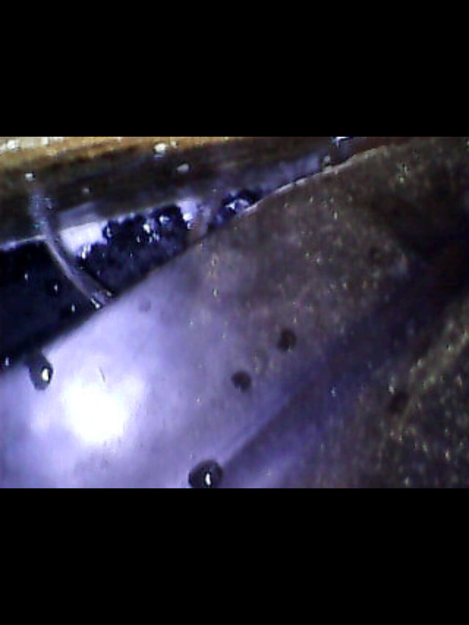

Old 04-27-2019 | 04:58 PM
Joined: Jun 2013
Posts: 113
From: Marco Island, FL
Just scoped my starboard housing with the leak; rotted right through on several areas. Shot...new gimbal time. Port does not look much better but isn’t Leaking yet...
