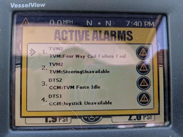

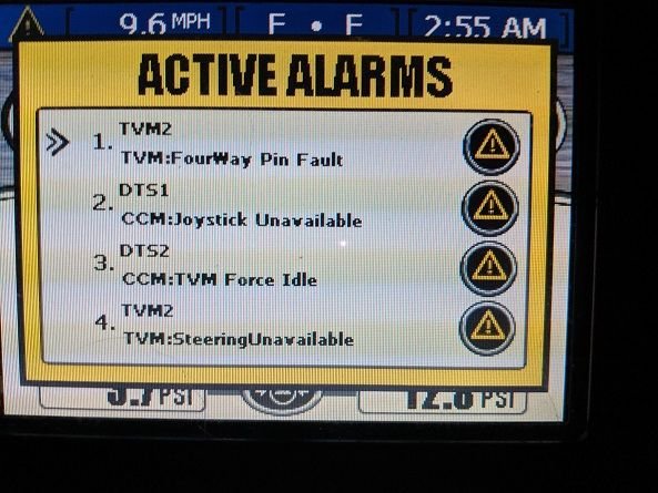

I made the mistake of again letting my batteries get too low and my boat started throwing error codes that I experienced in the past when I made the same mistake... After letting the boat charge over night I was still getting the error codes (but would still start normally) so I decided to try and reset the engine, turning off all the breakers didn't seem to make a difference (I saw the same codes as soon as I turned the key on) so I unplugged the ECM, engine power harness (I think) and the connection to the controls and dash. After plugging everything back in I now get a "low voltage" error even though my vesselview shows that I'm at 13.1v. Trying to turn the key does nothing (no crank), although I do sometimes see "start sequence aborted" on the VV. I disconnected all the same connections and checked for bent pins and to make sure they were seated properly but there was no change. Is the VV referring to a different voltage showing low?
I ordered a RINDA/DIACOM adapter/software kit earlier in hopes that it can show better information (and make clearing codes easier next time). I noticed one of their training videos showed two different voltages, one for the PCM and one for the ignition switch. As a side note, is there any reason that I should avoid having the adapter connected at all times? I'm installing a PC (based on an Atomic Pi) on my boat and if this is safe to do I'll just leave it connected at all times.
Error is the same regardless of whether starboard engine is on/started
Errors before disconnecting engine

Don't know what is installed on your boat, but some of the codes could be from items which where never installed on it. Such as DTS1 CCM:Joy stick unavailable, do you have joy stick control?

Yes, it has DTS and the joystick.
