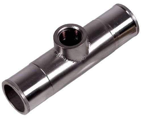

As mentioned and if you run a 'T' - You could use this after the pump and before the oil cooler. It has 1 1/4" in's and out's with a 1/2" npt.
https://www.hardin-marine.com/p-977-...se-12-npt.aspx
SB, this is basically what I did on my 3.3 whipple setups. Directly after the pump I have a 1.25x.75x1.25 "Y" fitting. I adjusted the depth of my transom mounted pickups (ended up quite deep at about 1 3/8" - 388 Hustler stepped hull) for proper water pressure on the engines (15ish - I dont have stats and I also dump off the rear of intakes so not much restriction). Seems to be working great at keeping everything cool. Trying to shorten the pickups even 3/8" resulted in high oil temps. The IC's get tons of fresh water this way, engine oil temps are happy, and engine water temps dont even register (below 120). You do need to cut back some idle fueling but not much to worry about. Some people talk that those pickups must be creating drag, however, the boat needs what it needs. Shortening the two main pick ups and adding a 3rd for intercooler dedication in my opinion would be as much, if not more, drag.
