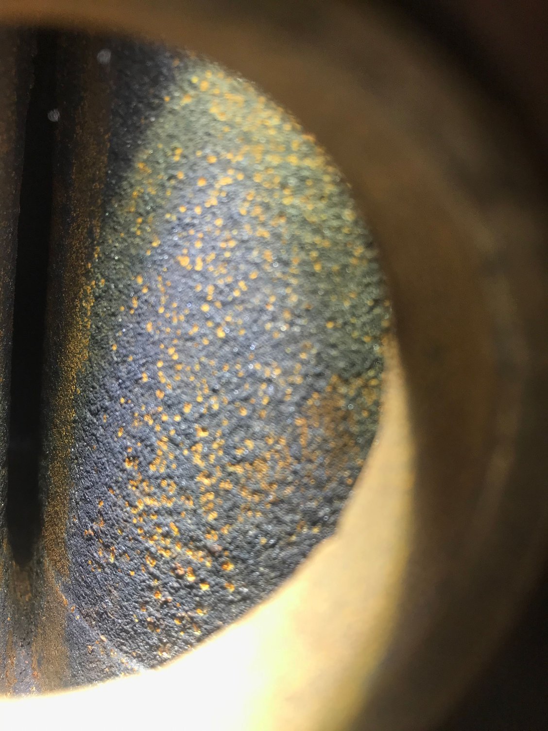

Well the blocks are bare, so I can try anything (and have). I took a look at them tonight and the scale is NOT going to come loose, so as long as it doesn’t cause heat transfer issues it will be ok I suppose. Anyone have pictures of water jackets in a raw water cooled engine that isn’t having overheat issues I can compare mine to? I don’t typically build blocks that were raw water cooled but I had these, now I’m second guessing myself.
here’s a pic of the scale:

I would be more concerned with the pitting on the cylinder walls than the oxide layer.
They look damn clean to me.

Same here. Those are some pretty deep and big divots. I have seen the black junk before and that isn't what yours looks like. Looks like corrosion from salt water.

The pits are in the black corrosion layer, up to 1/16" thick in places. The middle of the pits is exposed iron where I was chipping it off with a punch and hammer, its magnetite so its basically like chipping a thin rock/stone layer off. In the areas I have been able to get the black layer off completely the iron is not pitted very badly. I will double check the pits and wall thickness in those areas.

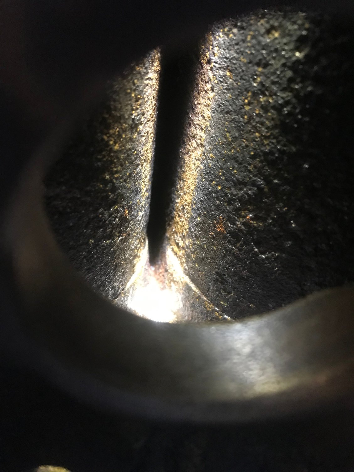

Here is a picture of that same spot now that I have them as clean as I can get them. This is how all of the surfaces look.
