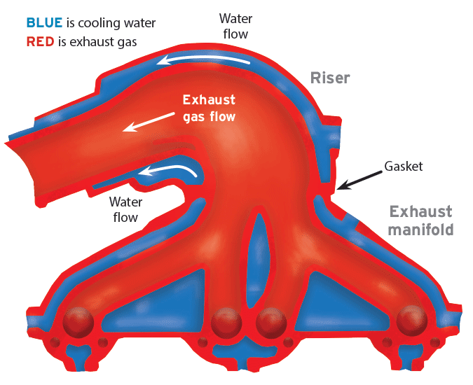

You might want to cap the bottom half of the jacket, and let water only flow out of the top half. This sort of dumps the water into the exhaust gas flow and the pulses "blow" it backwards and splash the inside of the remaining exhaust instead of just running at the bottom of the pipe. Like in this picture. This is the how stock risers and aftermarket risers meant for through-prop or silent choice/captains call are usually made (that I've seen).
An easy way to do this is like speedy said, and use 1/4" round bar (or whatever size fits in the jacket), it can be bent with the same radius as the inner pipe and tacked in.
