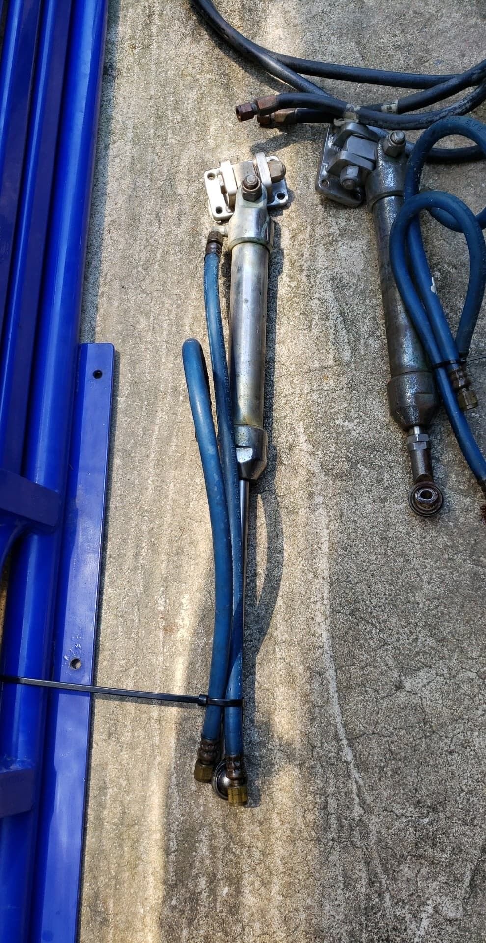

Old 06-15-2020 | 12:40 PM
Joined: Apr 2005
Posts: 583
Likes: 8
From: Long Island
21eagle is offline

Can I run H21 helm and hynautic pressure tank with these? I think they’re old lathams

Is this for manual hyd steering or will you be using the power steering pump?
Sounds like a manual hyd sys. If so, I have no experience with that.

Yea manual want to lose power steering pump. Do the hynautic pressure tank and helm
