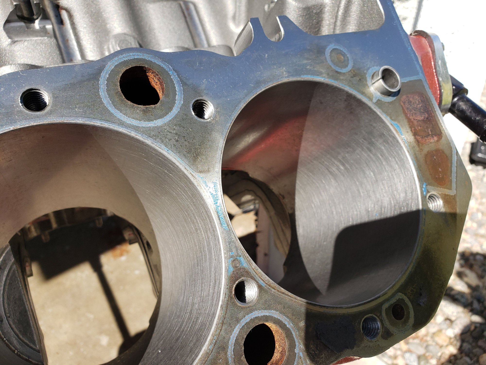

An update. I pulled the engine and took it apart. I installed new bearings and rings. I also honed the bores with a ball hone to make sure the rings had a chance to seat. The engine now has no crankcase pressure. I think since the motor was milked from startup the rings never seated correctly. All of the original rings were installed correct with no upside down rings. Always nice to find your problem.
Fresh hone

Interesting. Wonder if the instant milkshake caused the rings to overheat due to excessive friction making them loose their tension??
Anyone ever try to measure ring tension? Don't remember ever seeing it spec'ed.
How did the bearings look?

It could have been caused by glazed cylinder walls. Running a motor on a stand for longer than it takes to set timing and look for leaks is just not good for them. It takes load to build cylinder pressure. It takes cylinder pressure to seat rings. I've found that by putting an engine on a Dyno and getting it underload ASAP not only gives less crank case pressure they make more power. As soon as timing is set we run a computerised break-in that runs the engine to about 3000rpm and back to about 1200rpm at 60% load. You can do same thing in a boat. Run it on hose just long enough to set timing and look for leaks. Then launch and get underway and accelerate/decelerate repeatedly for about 15 minutes. You'll be surprised at how much better it'll run. Once break-in is done go over the valve train and double check the timing. Change oil and filter if you want. Then go run it full throttle and back to idle several times on about a 10second pull and get out of it as if you were making Dyno pulls. Then use it however you want.
