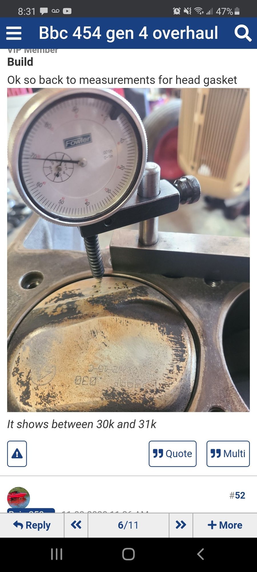

How are you measuring? Depth mic?
Baja 250es 11-10-2020 07:32 PM
Build
https://cimg5.ibsrv.net/gimg/www.off...0da5390d16.jpg
This was an earlier post
Smitty275 11-10-2020 07:34 PM
That puppy is all over the place. Someone did a piss poor job resizing the rods to have that much variance. Can only cut it to the highest piston.
Baja 250es 11-10-2020 07:57 PM
Build
So the most i can take off is .10 across the board and run the thinnest gasket i can find correct
Baja 250es 11-10-2020 08:08 PM
Build
Will i really notice the difference if I send out tell them to make sure it's true and flat cut .05 off on both run thinnest gasket and call it a day or is that a bad idea I mean the boat ran good before I tore apart but I did not have a blower before either
sailtexas186548 11-10-2020 08:57 PM
No (assuming you mean .005) at best it will help head gasket sealing.
a set of scat I beam rods with arp bolts is under 400 bucks if resized rods are causing the irregularities... then you get into balancing, etc so you have a decision to make
