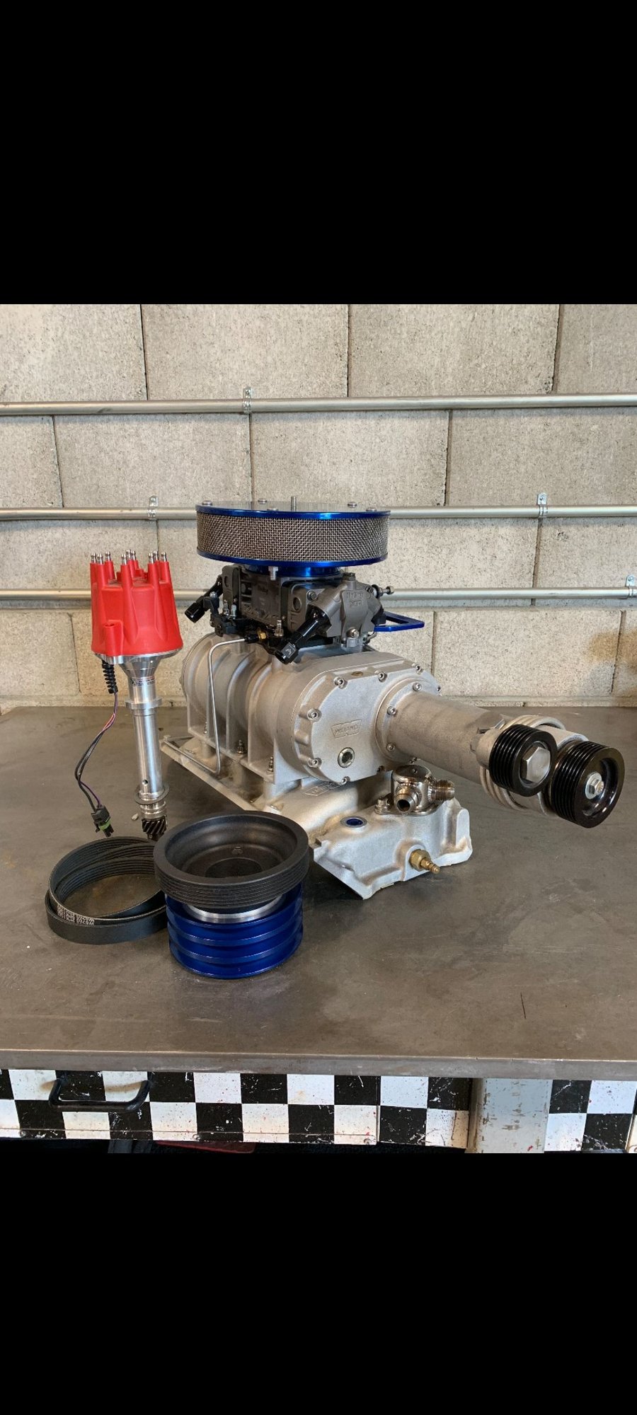

I can't tell what carb that is.
Since you're running an aftermarket distributor, figure out your electronic advance and lock out the mechanical advance.
What ignition box/amp are you gonna run?
