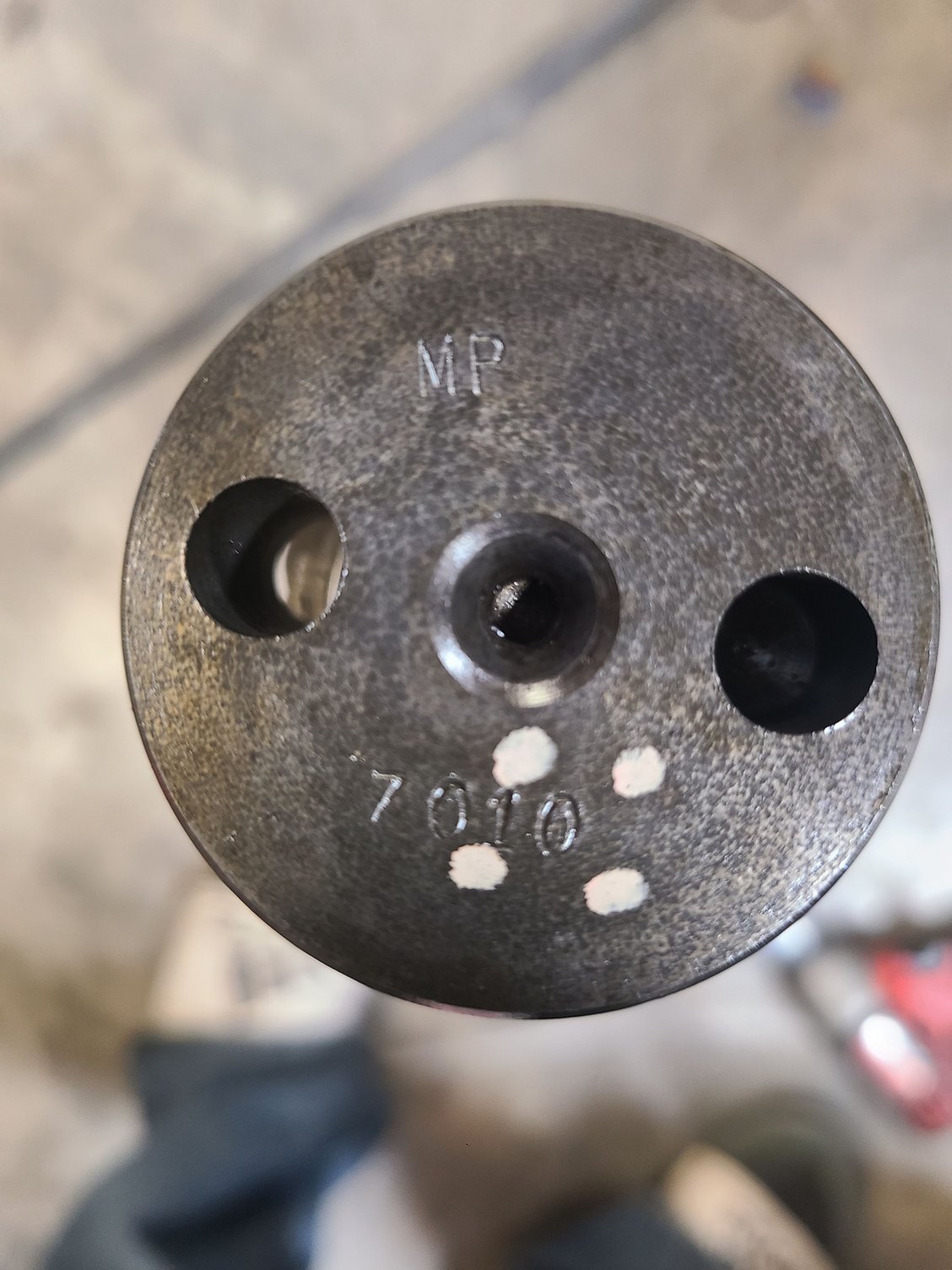

Baja 250es 11-04-2020 07:11 PM
Build
https://cimg8.ibsrv.net/gimg/www.off...14b402d28e.jpg
Im guessing this one is stock i can't find much on these numbers anyone recognize
mcollinstn 11-06-2020 10:15 PM
Your 454 Mag came with forged TRW pistons.
The .030 over SpeedPros that are in it now are the correct "cross reference" piston (similar dome, etc to the originals).
I do see that somebody has bore-notched your block (this is good) to unshroud the valves. That's good for 5 free hp (more on a high rom motor).

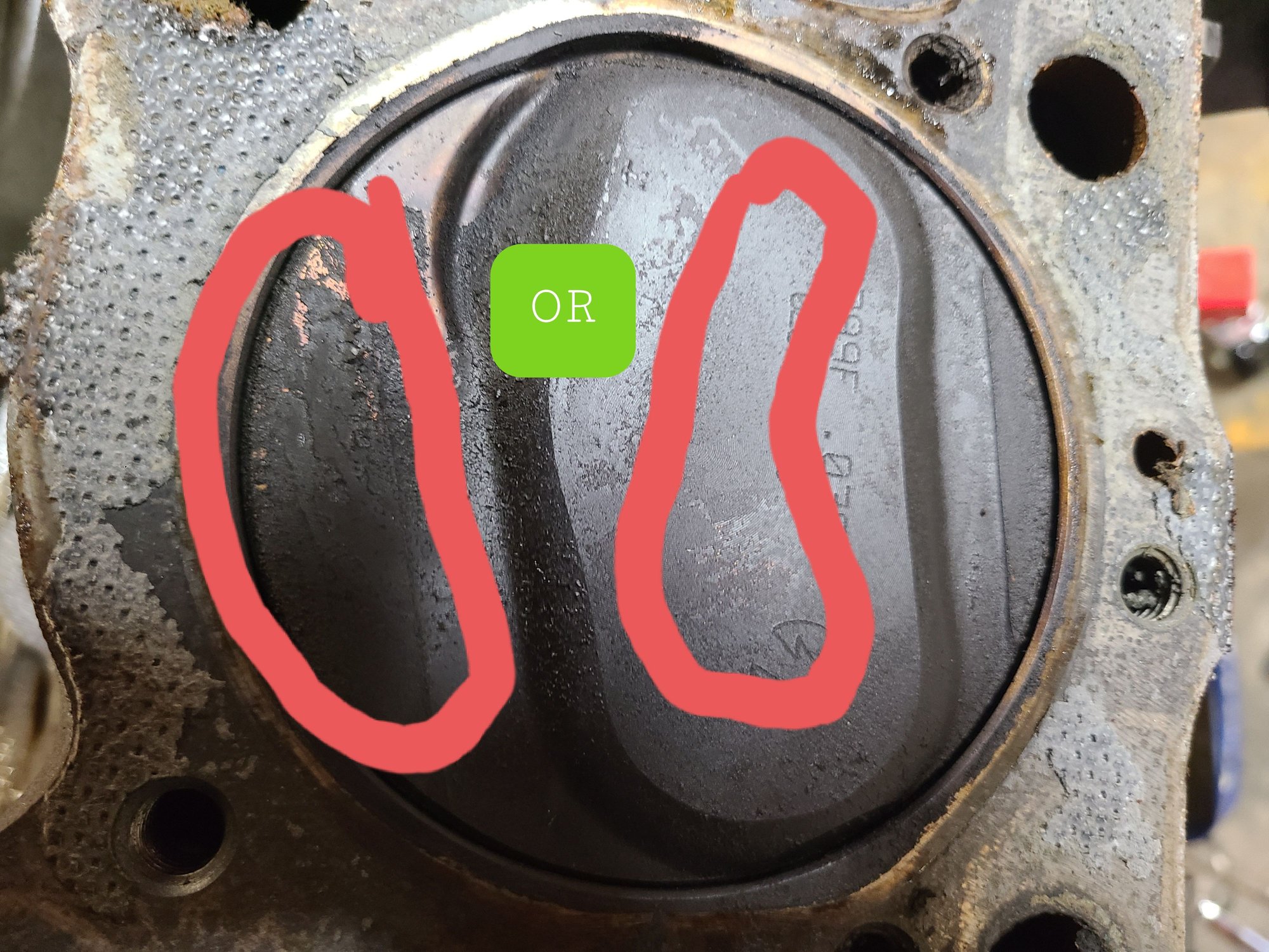

Ok mcollinstn I am going to put a wieand 177 charger on it for sure I just bought it it is setup for 5psi, to check quench on these pistons properly do u check beside or on top of the dome there are 2 flat spots ?
Baja 250es 11-07-2020 06:17 AM
Build
https://cimg5.ibsrv.net/gimg/www.off...15768073e9.jpg
In my diesel world its the highest spot but all my pistons have a flat ring around them
sailtexas186548 11-07-2020 07:20 AM
Left (not the dome)
Baja 250es 11-07-2020 07:23 AM
Build
Thank u sailtexas
