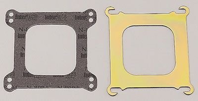

What part # Eddy intake ? Got a pic of it on the boat ? What I’m getting to on intake questions, if a spread bore intake, it needs a thin adapter/sealing plate between squarebore carb and spreadbore intake for carb baseplate gasket to seal.
Edelbrock 2732
Edelbrock 2732
Shoot I get rid of the 1" adapter that's on it right now and just use the sealing plate and gasket you showed here? Or use both the sealing plate and the 1" thick adapter?

Plate:
open spreadbore gasket on intake
then plate
then open squatebore gasket
then swuarebore carb
1” adapter - which is it ? Various styles ?
If completely open (no 4 throttle bore holes)
-open spreadbore gasket to intake
-soreadbore side of adapter to spreadbore gasket
-open squarebore gasket on top of adapter
- squarebore carb
then plate
- squarebore carb

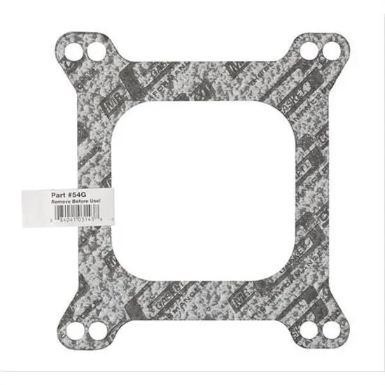

#139
Joined: Jun 2020
Posts: 523
Likes: 187
From: Holland MI
Can anybody give me a part number for a spread bore base gasket with the 5 1/8" width hole pattern? The square bore gasket I got has both sets of holes but the spread bore gasket I got only has the holes 4 1/4" apart.
