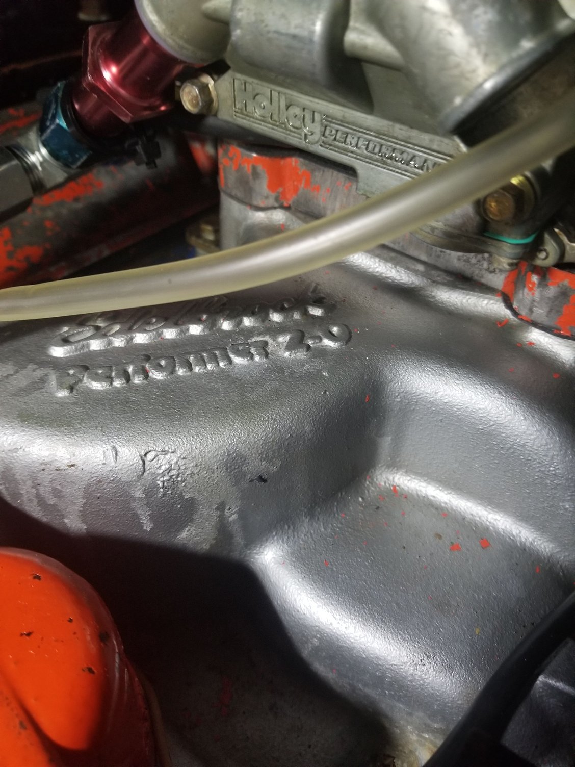

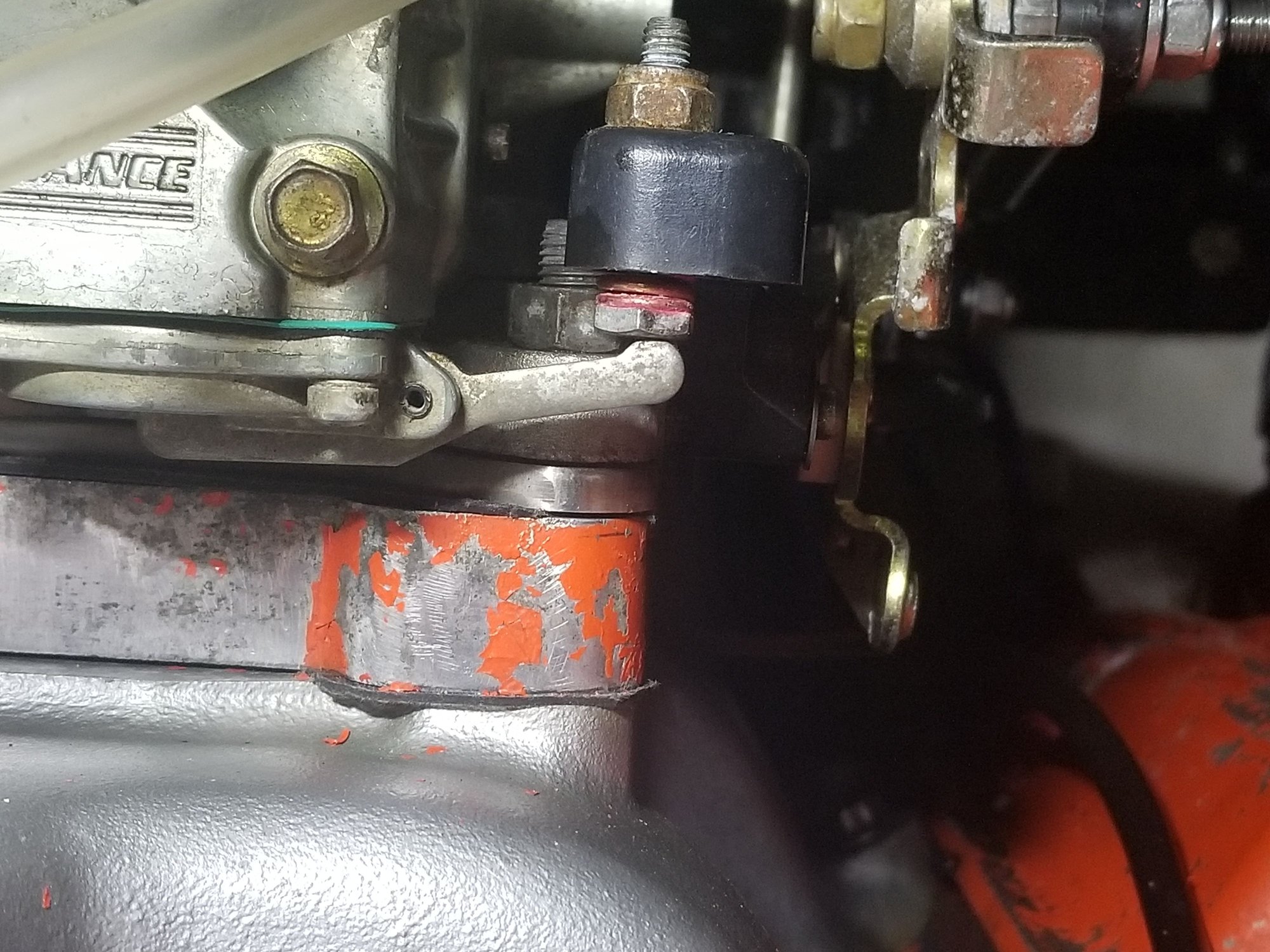

Is this a 330hp454 or 365hp 454 ?
What part # Eddy intake ? Got a pic of it on the boat ? What I’m getting to on intake questions, if a spread bore intake, it needs a thin adapter/sealing plate between squarebore carb and spreadbore intake for carb baseplate gasket to seal.
Edelbrock 2732
Edelbrock 2732
I'm not sure which 454 it is. It's a 1993 with a bravo 1.

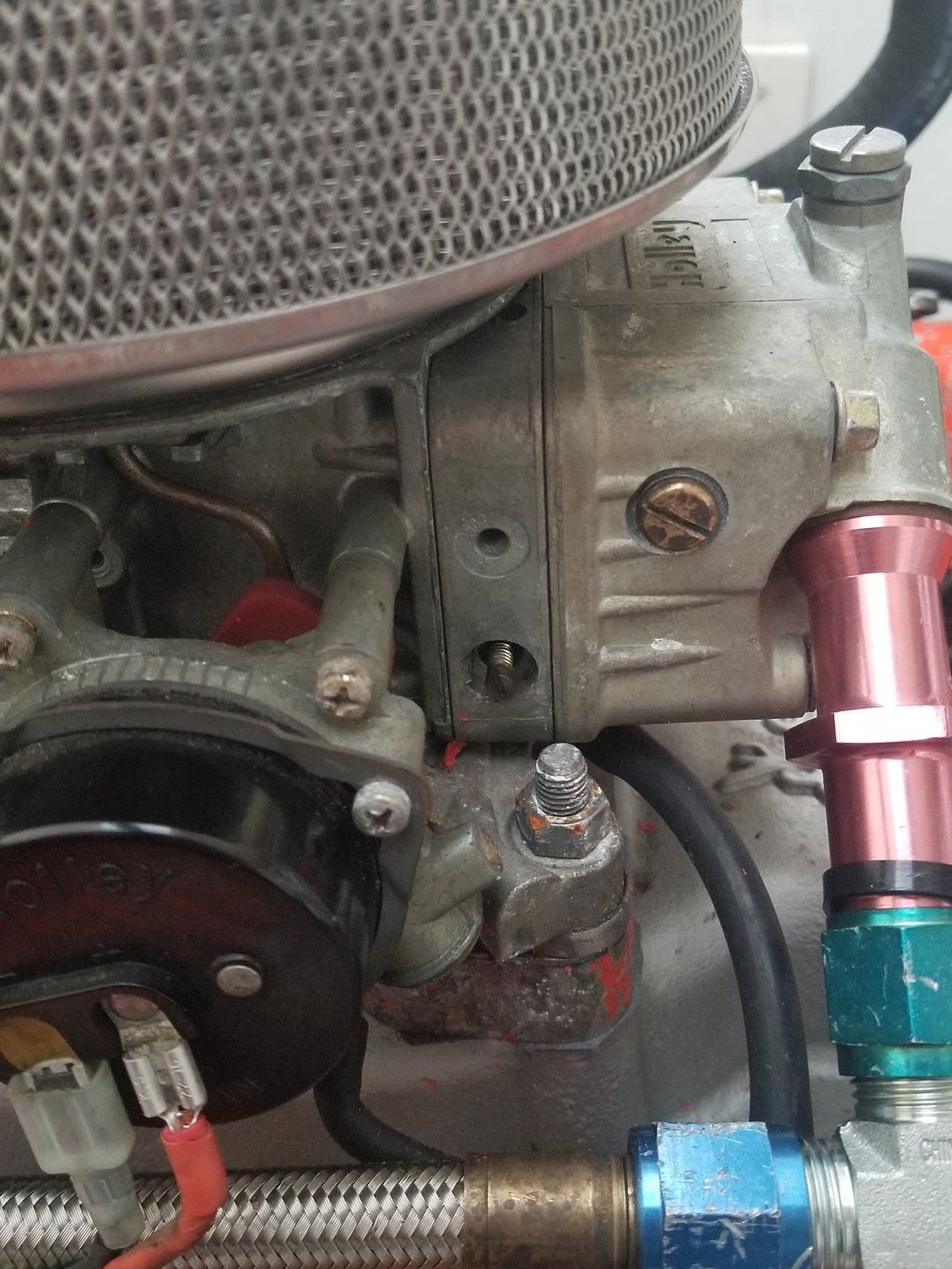

Have more questions before statement . This is your pic from post #14. Where does that black vacuum line from carb go to ?
It is capped off
