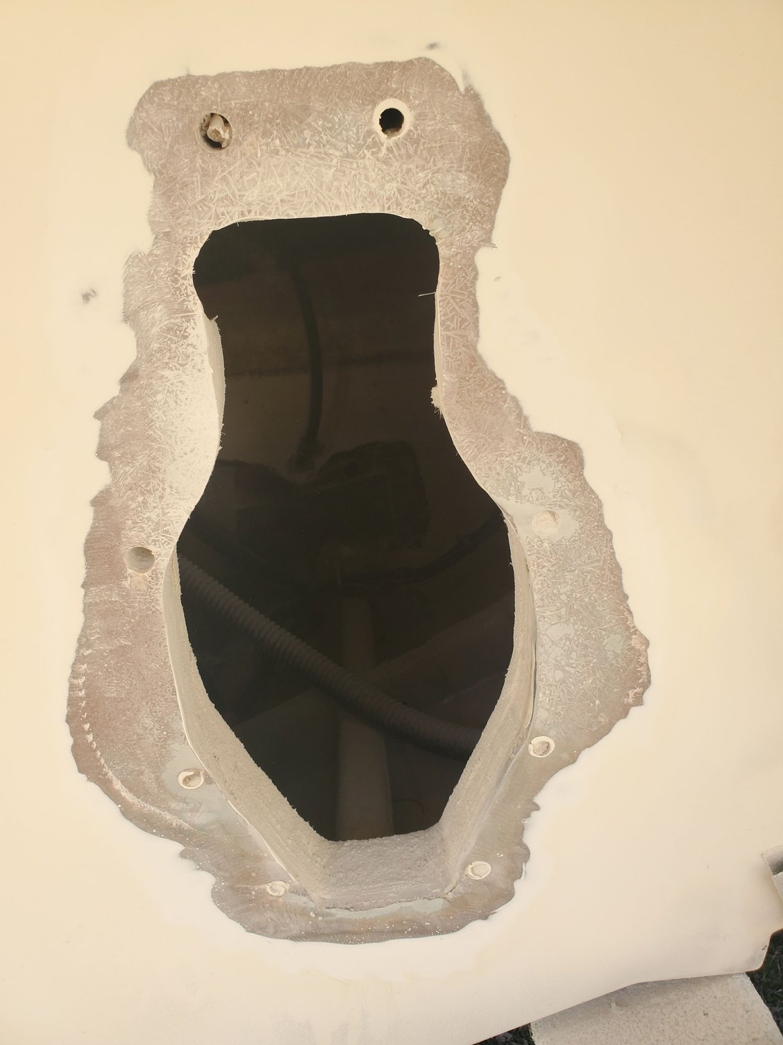

RSWORDS 02-23-2021 08:14 PM
Thanks for using 5200 to seal the transom assembly....
Yeah...
So it pealed the gel off and exposes the glass..
Some epoxy and paint? Marime tex? Grind it out and glass it?
I'm not a glass guy. I can glass, I can make it strong and look good. I have no idea how to judge the damage and proper fix though.
https://cimg2.ibsrv.net/gimg/www.off...7aa6bbb41a.jpg
https://cimg9.ibsrv.net/gimg/www.off...c5967066e0.jpg
smashm 02-23-2021 10:01 PM
I'd inspect it thoroughly for any pulling or delamination from the inner wood. I'd it's still solid, grind it, glass or just resin if needed & reshoot the transom. Not a huge undertaking. Just my thoughts on it.
RSWORDS 02-24-2021 06:10 AM
it hasn't pulled away from the inner structure at all.
That's what I was thinking but not sure.

So I ground down, it's gonna need some glass.
https://cimg1.ibsrv.net/gimg/www.off...7a8ee219c8.jpg

Looks good though! Leak and tearoff off of drive didn't seem to do too much damage! Still a pisser to have to go through all that though! Keep us posted!
