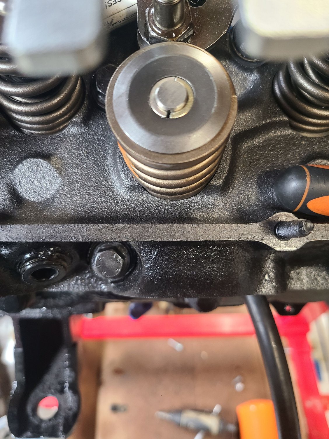

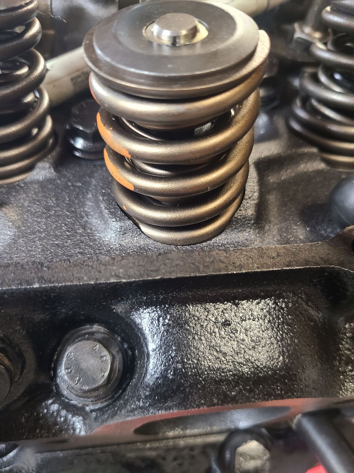

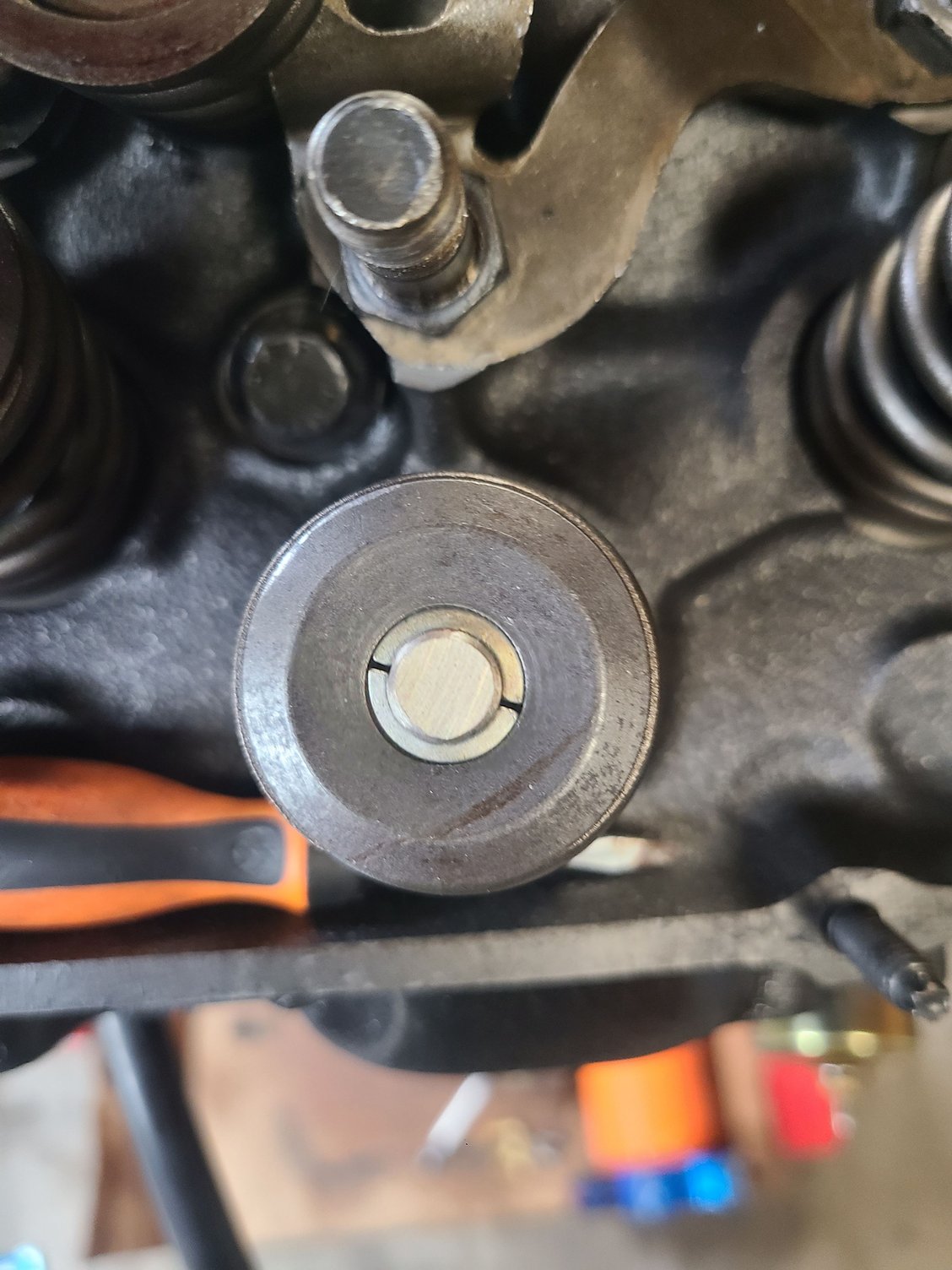

I need some assistance I'm guessing the stock spring retainers will not work with the comp 930-16 valve springs and also these springs say I need head machine work done what the hell it doesn't look like I need anything but different retainers can some one shed some light on what to do about this thanks
New spring with old retainer on it i was looking at the over hang
Stock spring stock retainer
New springs 930-16

Looks like it sits on the head just fine

Do you have a picture of your heads without the springs on them ?
