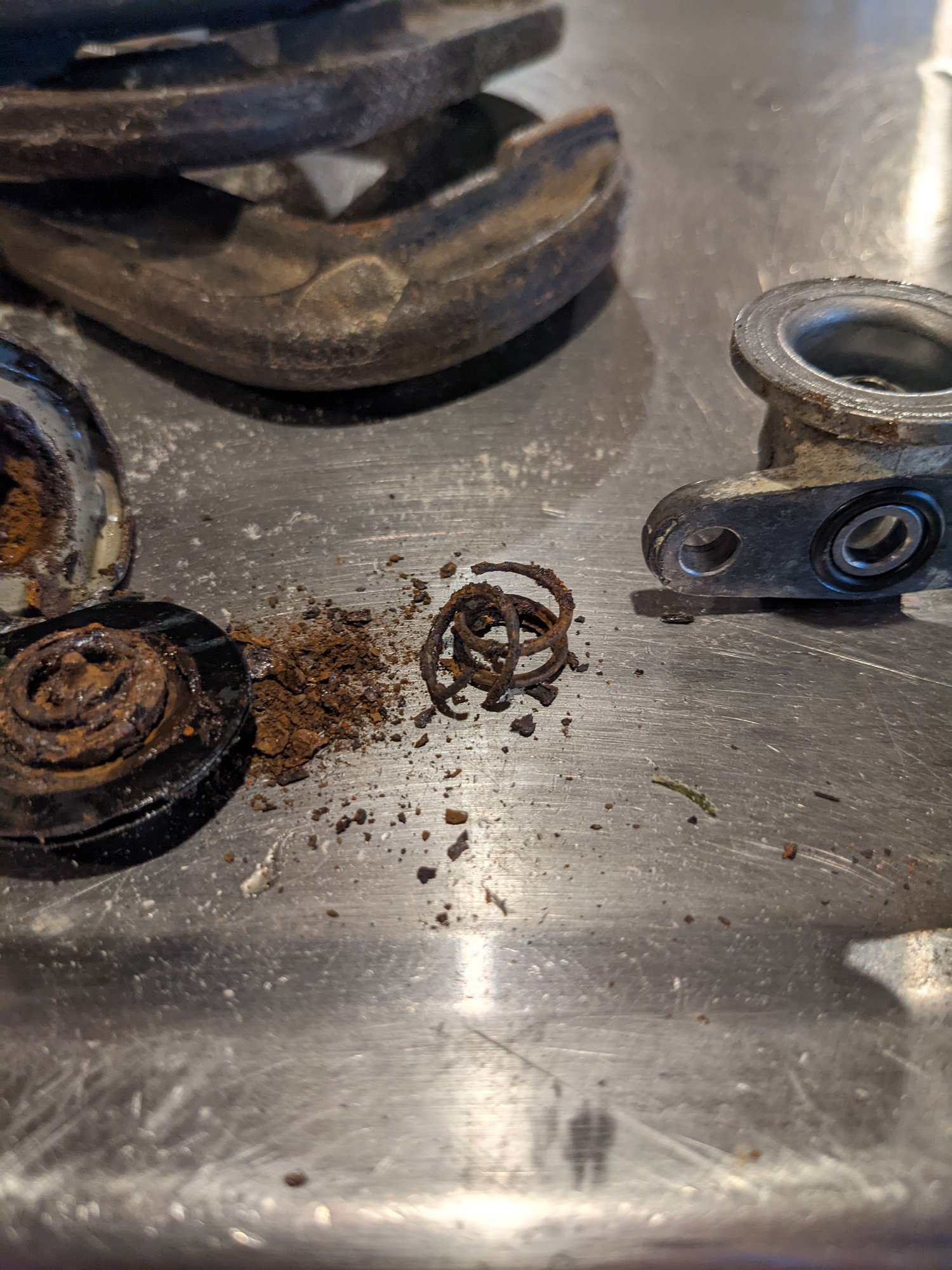

Old reg would go to 19 psi with key on (Priming. Not starting) t. New reg goes to 43! Bad reg. Haven't started it yet. I think I'll wait for the fuel that I spilled to dissipate first. No idea if this will fix my hard cold start, but it was certainly an issue.

So I think I found my low fuel pressure problem. Now FPR brought me right to 43 psi. I opened the old one up and found a bit of a mess.

Looks like plow trucks frames and rocker panels up here. Yikes !

How is that even possible even in salt water? I replaced one this week because one engine was running 300 RPM lower than the other. I’ve been chasing this for a year. Computer throws no codes. I have recorded both engines and they both run the same.

My thoughts are that the vacuum line fell off at some point or seawater was drawn in at the connection. It is a very loose fitting vacuum port. I know the PO had a bilge flooding event while fishing. I know he rinsed and cleaned the bilge and motor after, but you'd never rinse this out.
