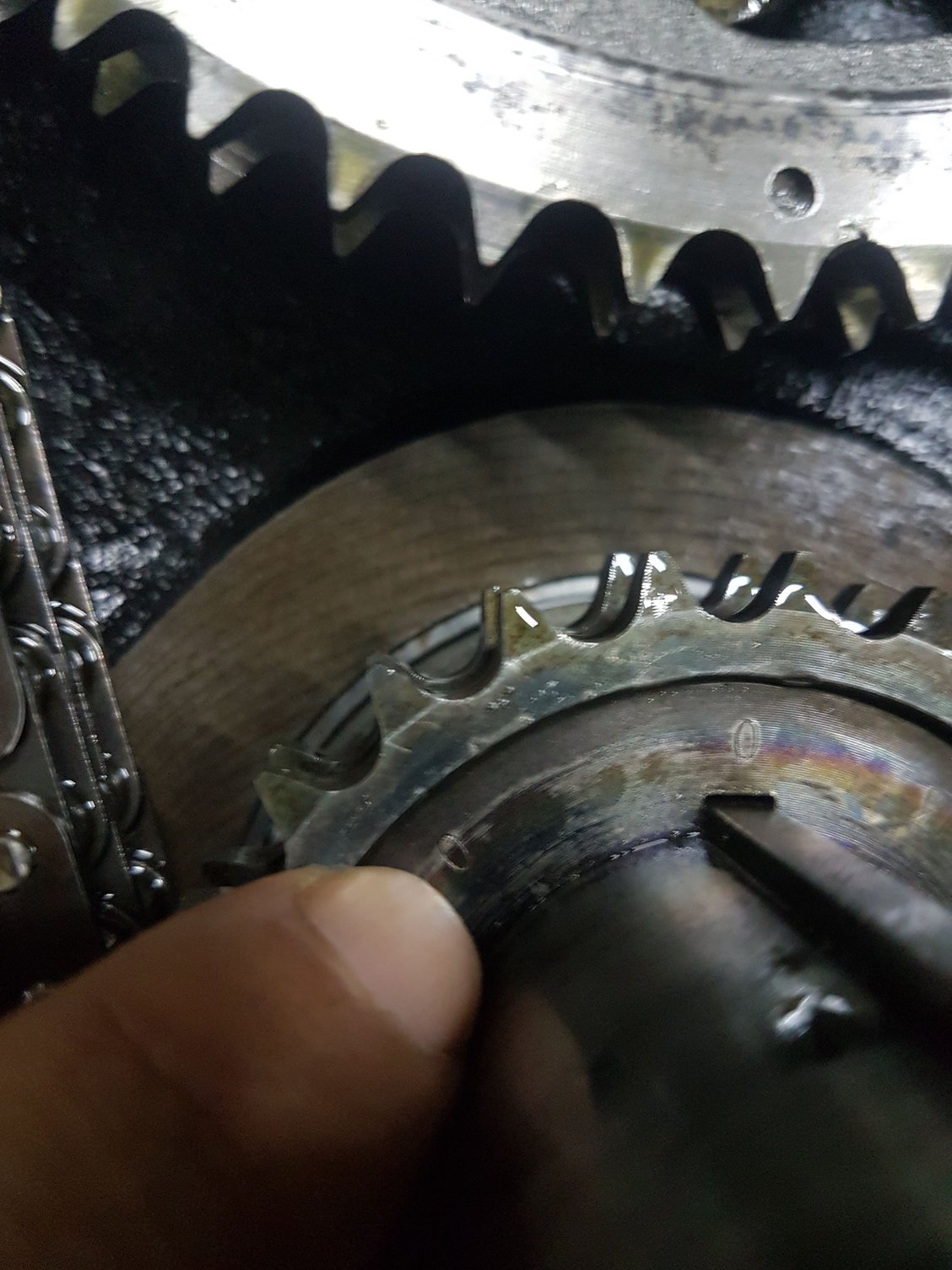

YOU are my favorit profesor SB...So you think the litle chain gear that goes on the crank was mounted wrong and because of that the cam is too advance...yes?
SB 01-10-2023 10:34 AM
If it has multiple keyways, than very possible.
Many gears, include factory OEM, only have one.
Many of us still use a degree wheel to make sure the cam is in where we want it. Many don't.

Zole 01-11-2023 01:34 PM
Hey crew...yust a update from yesterday..I opend up my faze chain.
https://cimg4.ibsrv.net/gimg/www.off...6b4f247d8d.jpg
This is how it was done and it was not good..
https://cimg6.ibsrv.net/gimg/www.off...ebb71ee2da.jpg
But when i put it this way then it is ok
