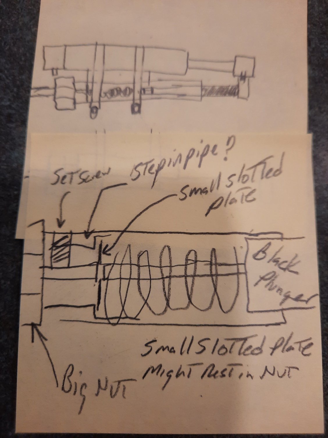

I have a call in to Eddie Marine for some help but again, I thought I would ask here too. I am hoping someone has this system and can tell me the correct sequence for these parts. I was able to attach the through transom pieces without incident. I have the cable stuck through and ready to assemble and install the actuator parts. I have attached a couple pics. The one pic is of the parts that came with the cables and I need to know if these go back on too. There is only one video on youtube and he doesn't explain really anything and I also think his kit is different than mine. Thanks again for your help.

Maybe like this. Put nut on tube, push cable thru nut/tube till end emerges, place slotted washer over slot in cable end, slide in tube a couple of inches, slide spring over cable, compress spring, screw black plunger on cable end, release spring, slide into tube, sinch cable with set screw. Mount to cylinder, mount ring to ram nut.
The diagram you have is for actuators like second pic that clamp to cylinder and ram modified for outboard use. Your new one clamps to cylinder only. On yours the Plunger bumps against bushing attached to ram mount nut. Not sure where the big slotted disk goes. Small boots and nut are for cable and may or may not be able to use them depending how it goes. Sorry about the sticky note shop drawings.
