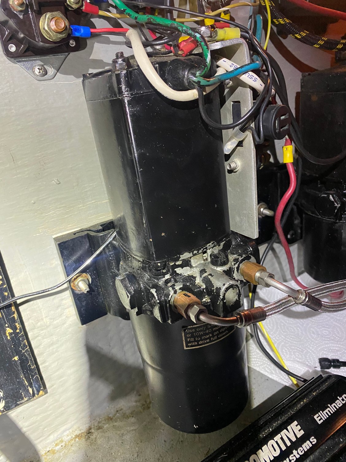

Pump is good, motor smoked due to switch sticking. Want to identify the unit so i can source a replacement. 87 CC but don’t think it’s original

Captain, looks like an old Oildyne Pump/Metal Reservoir from Mercruiser. I've got 4 of them, I just keep rebuilding them. The Mercury ExParts viewer shows the motor replacement as part number as 17649A1. I also checked the K-tab part list and they show two different motors based on whether your wires have a spiral white tracer or straight tracer on the blue and green. The spiral tracer motor is 17649T and the straight tracer wire marking is 891736T. If you do a search for the first pump serial number, you'll get a bunch of info! Good Luck! Oh by the way, I think there a 9/16" capscrew behind the motor that holds it down in the v-block mount!

great information! Thank you!!

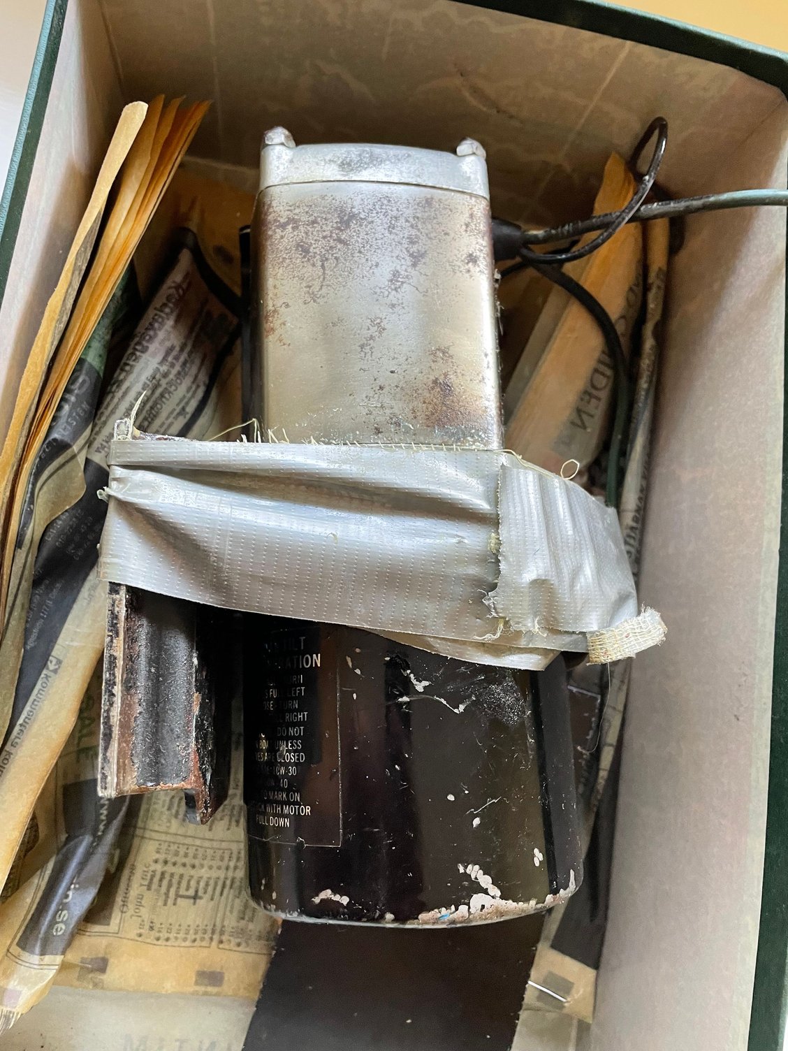

Is this the same style?
Mercruiser Oildyne trim pump
that looks like it!

I can bring it with me to the United States in late July.
