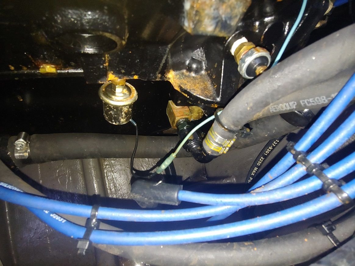

I hope I thought this out correctly, I already had a engine block remote adapter leading to the remote oil filter (hose #1), leading to the oil cooler (hose #2) and then back to the adapter on the block (hose #3).
I expect to add just one hose (new hose from remote filter back to thermostat, frankly I plan on repurposing hose #2 and making a short hose for one going to the cooler)...again trying to minimize changes/variables. I understand AN 12 hose would be better but I have AN10 everywhere else. I'm assuming these clamped fittings (see picture) are also available from Jegs/Summit.
