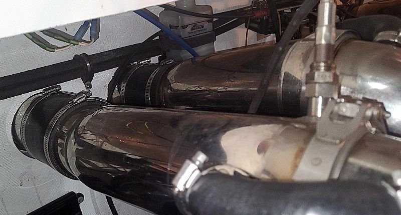

Here's some pics of how I used the silicone "couplers".

I've been using this 500°F turbo/intercooler hose for the last 7 years to couple my tails to 4" extensions to exit out my transom.with no issues. I needed a little extra "bend" to get my CMI E-Tops to align with my exhaust holes in my transom
https://www.ebay.com/itm/20351937285...Bk9SR9KZgJi-Yg
So this has a little more "flex" than traditional Marine wet SAE J2006 "rubber" coupler?
Yes, a lot more.
I do run them wet. Water enters at the connection.
