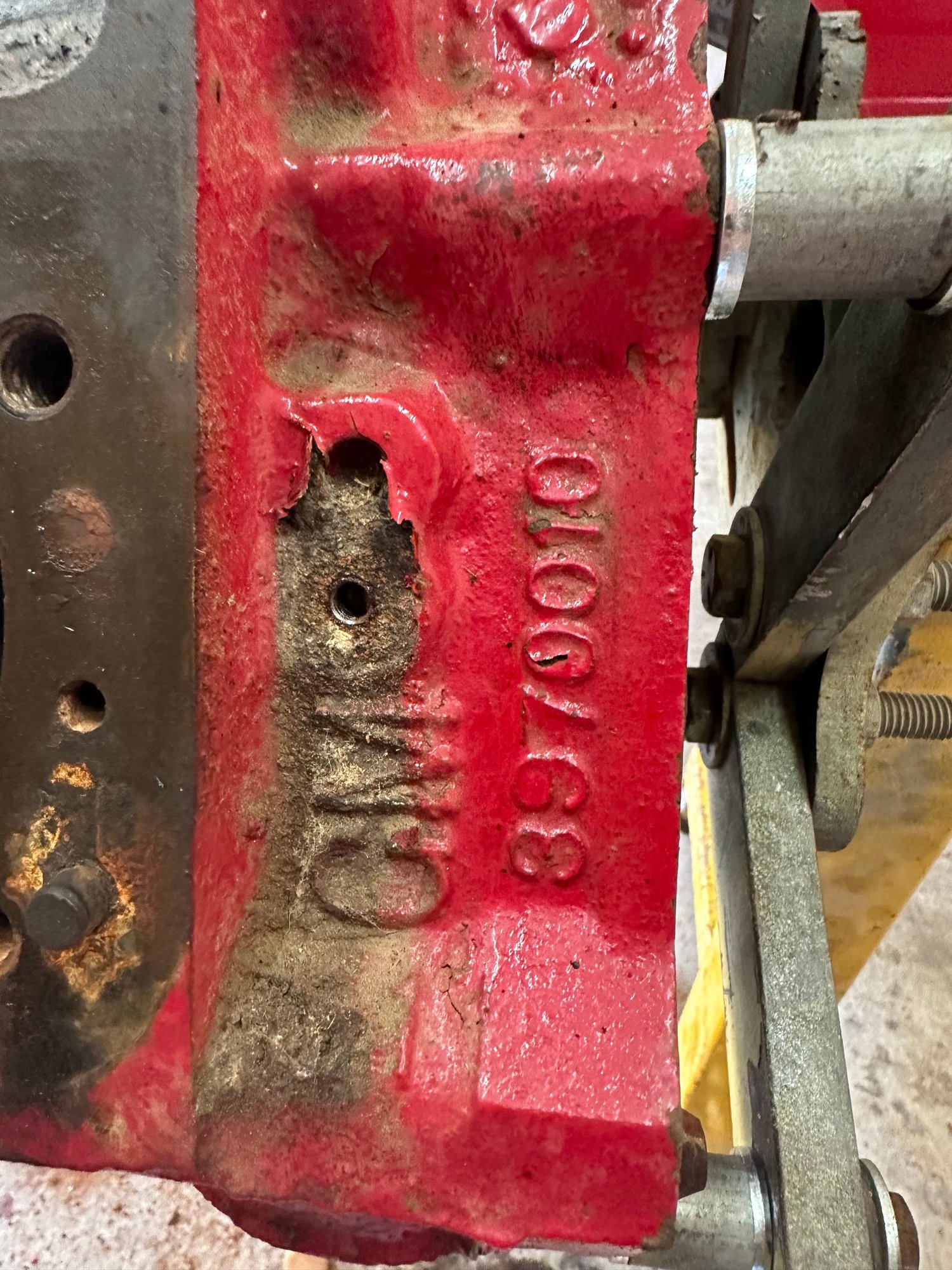

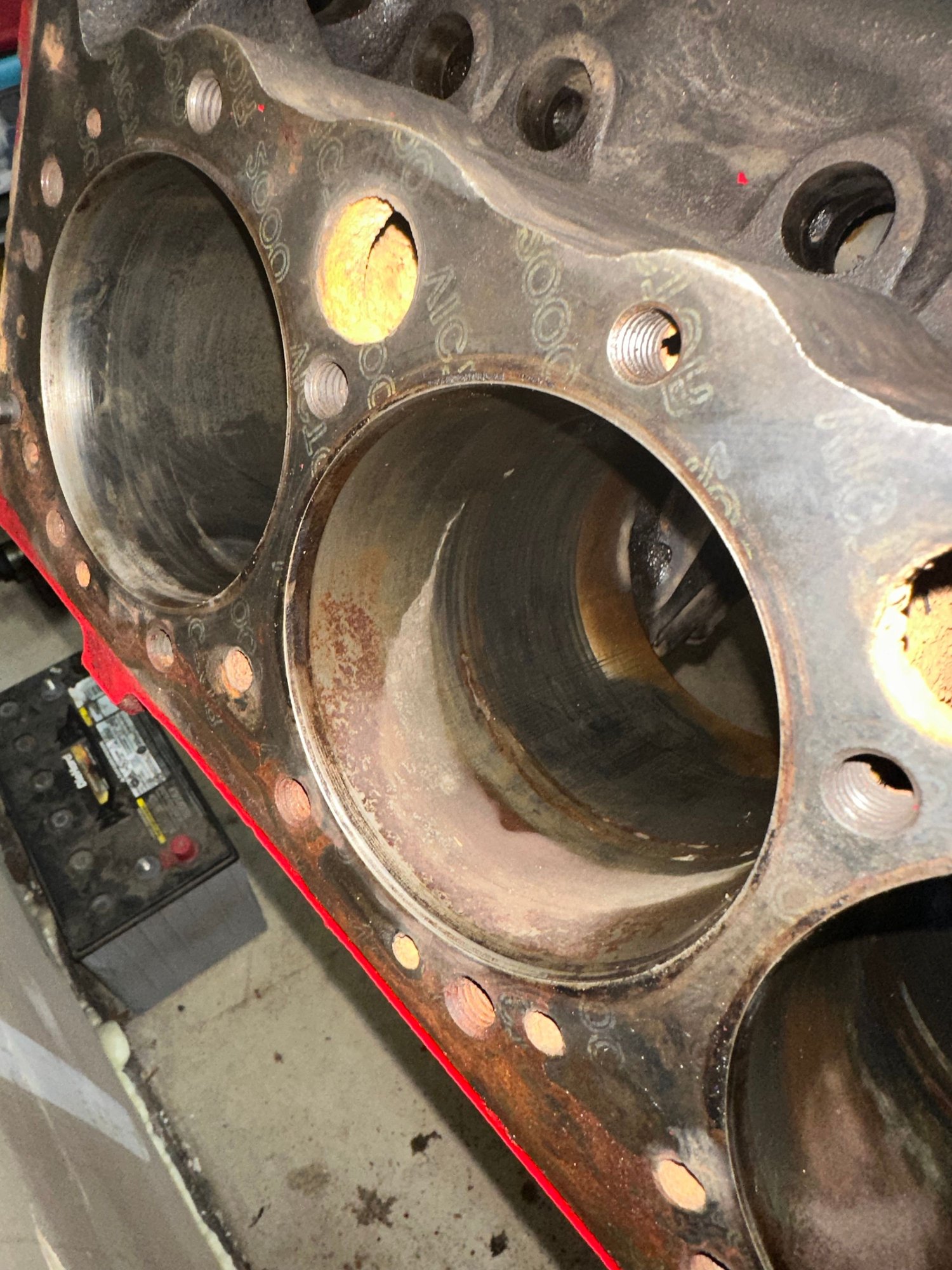

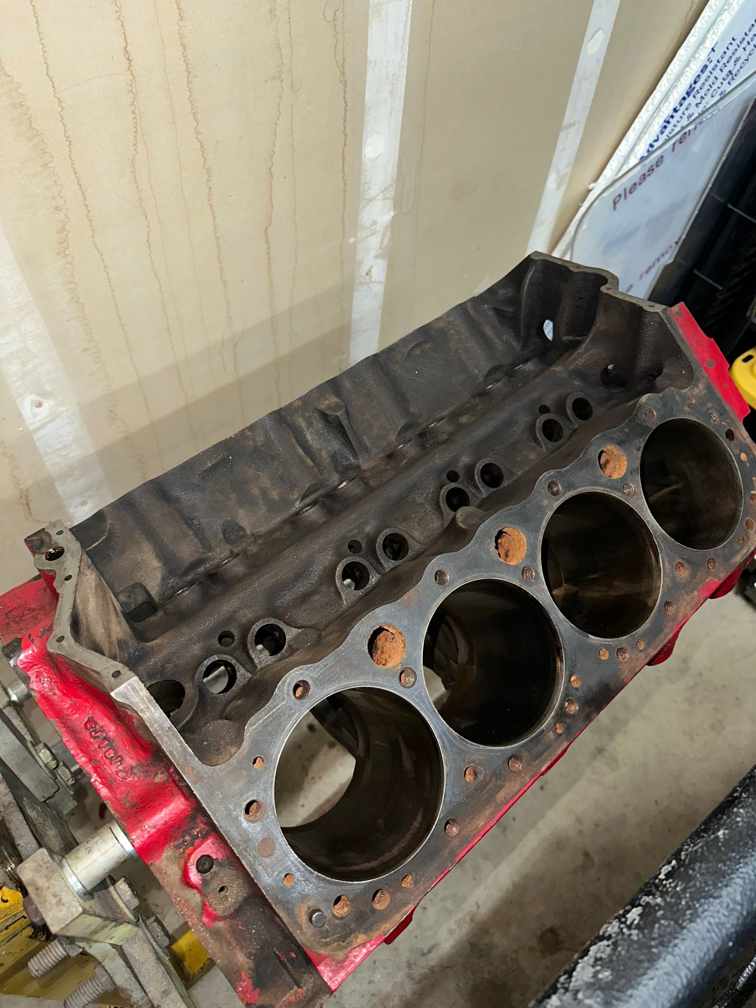

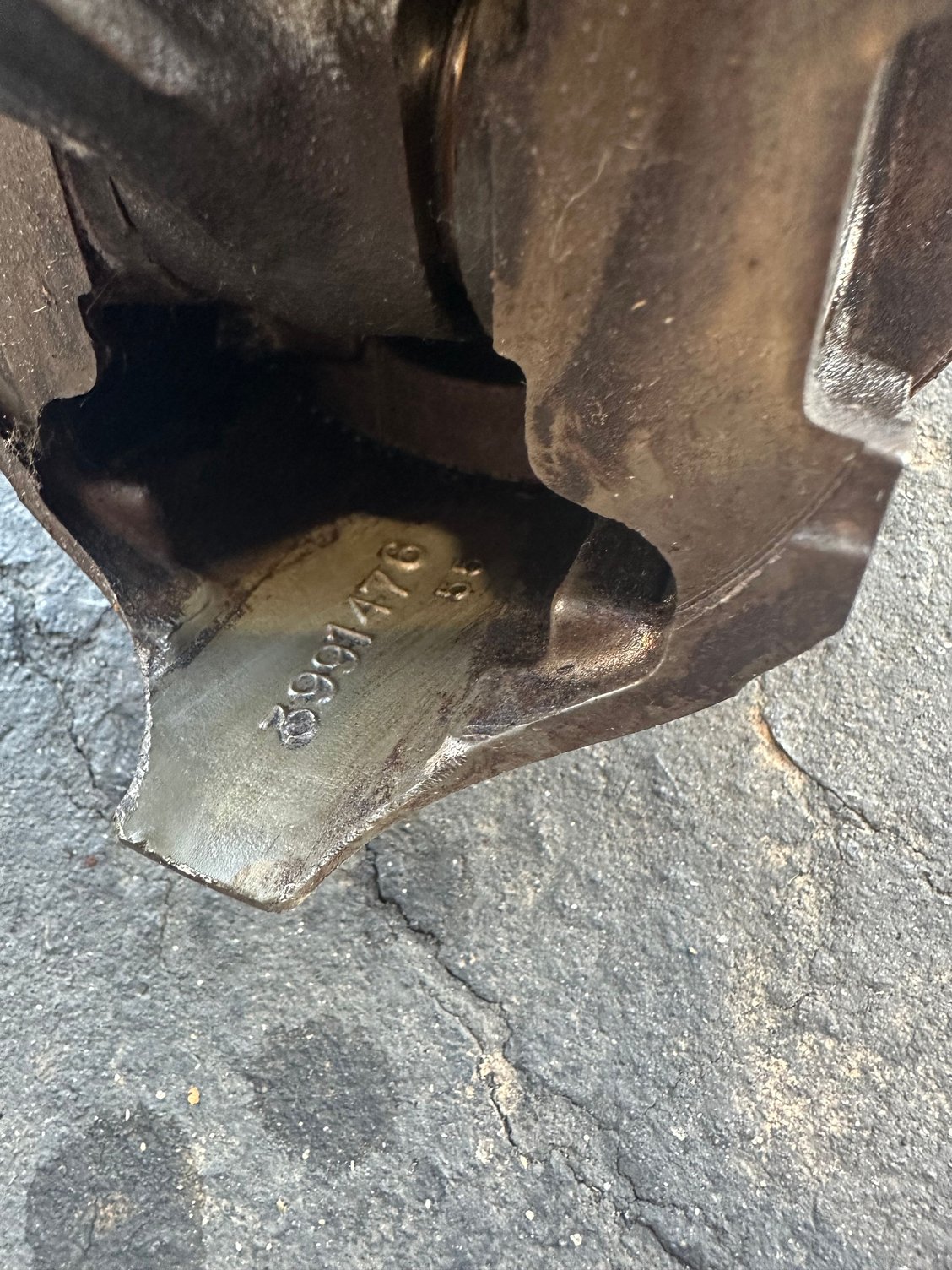

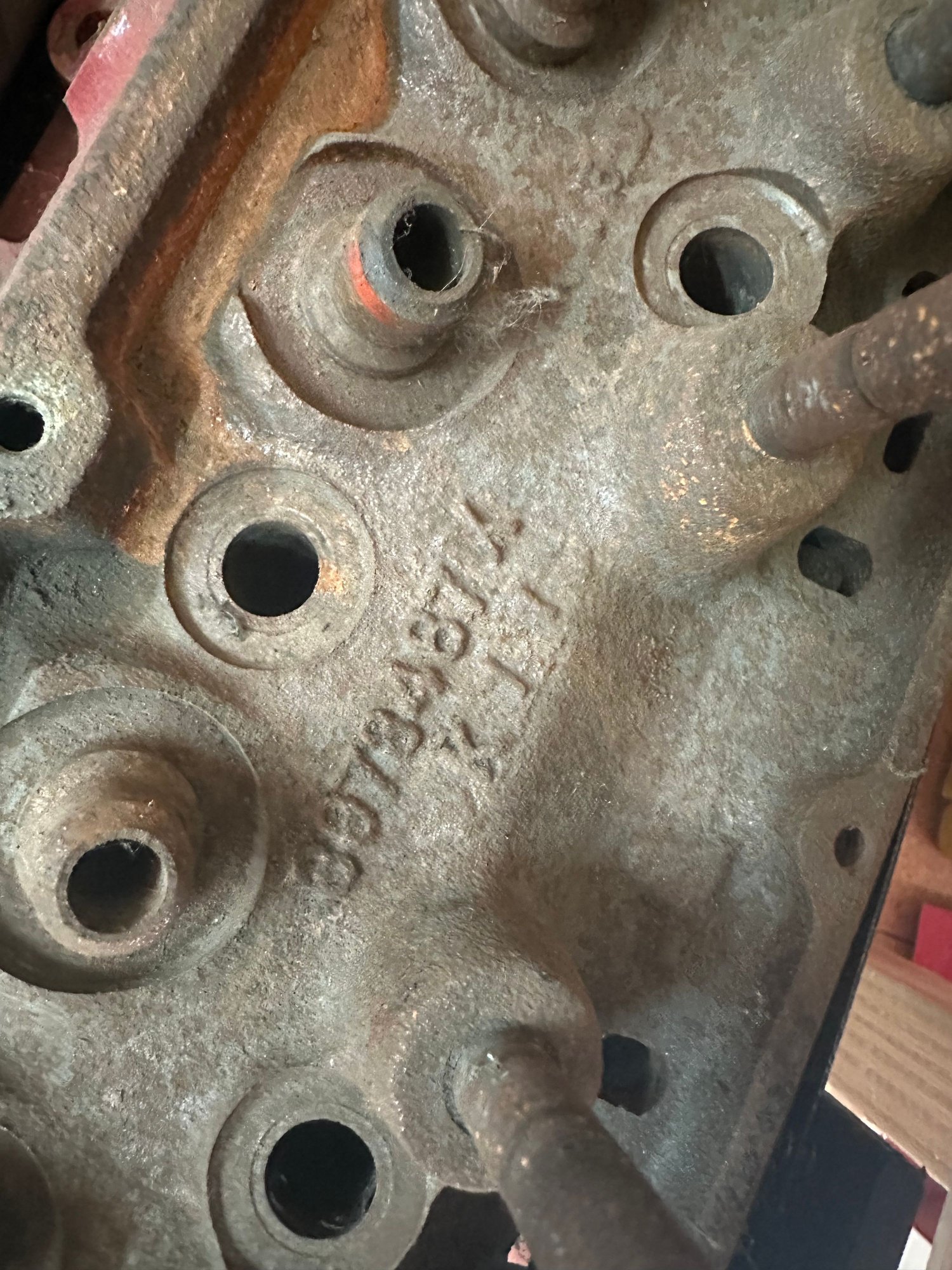

Here are the pictures of the 350. You can see its casting number as well as the chipping. One of the pistons has some wear on the top, maybe from detonation?

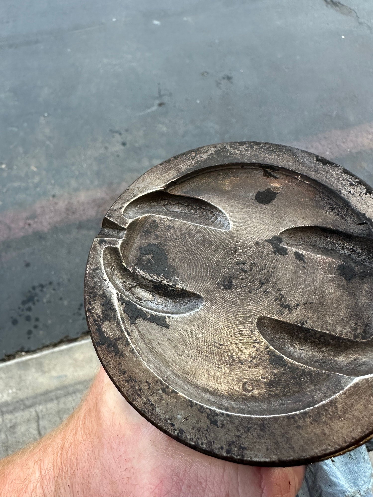

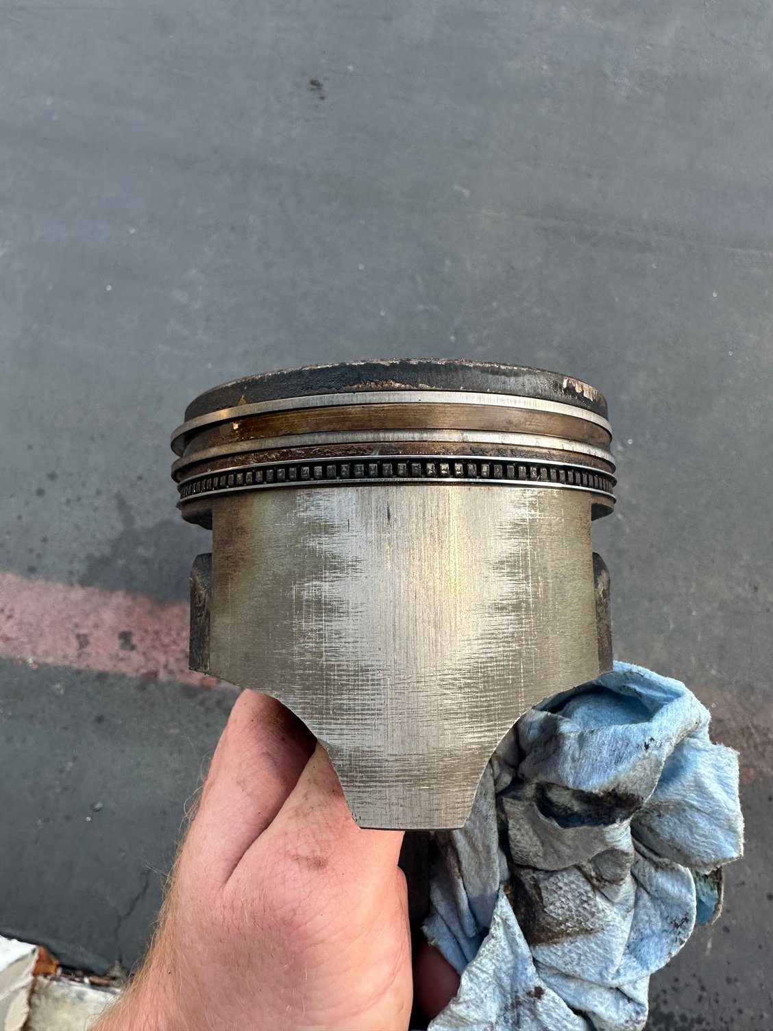

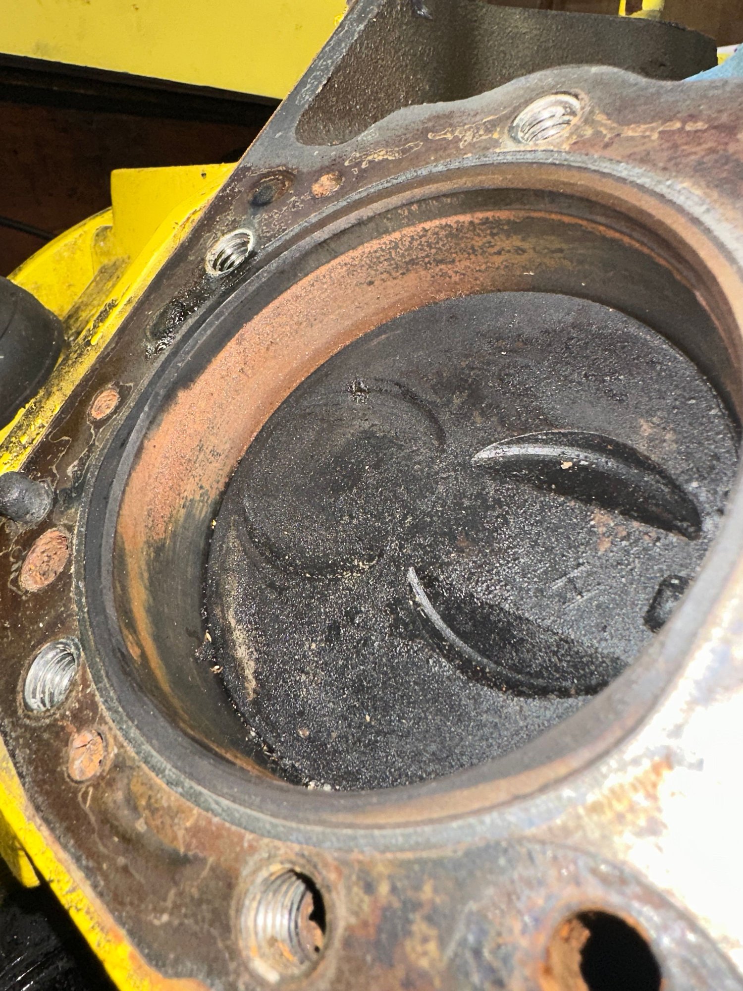

Here are the pistons:

How many bolt mains you have?
id for sure have that block checked out. Overbore pistons and all new looks like a given. Line honed, decked, new heads, new bearings, connecting rods, cam, lifters, rocker arms, pushrods. I’d look at doing a 383…maybe a 396. Skip white has excellent parts kits. Lots of head options out there.
intake manifold
carb will be a choice depending on what route you go.
all comes down to budget and power requirements. Not just about doing this work…which is very doable if you have skills, tools, and manual. But do you know how to make all this work together that’s the art.., cam, heads, piston, carb etc.
intake manifold

Tough call.
The 305 block actually looks a lot better than the 350. The 350 looks like it has a ton of corrosion in the water jackets. Heads dont look any better
You cant put the 305 heads on the 350. It bumps the compression up too high.
Depending on how fast you want to be I would freshen up the 305 and put it back together. Just do the bare minimum. You can probably do that relatively cheap compared to doing the 350. Get the boat done and see how it is with the 305 in it. You can then decide if you want to upgrade the power. At least with a jet its fairly easy to swap the engine
