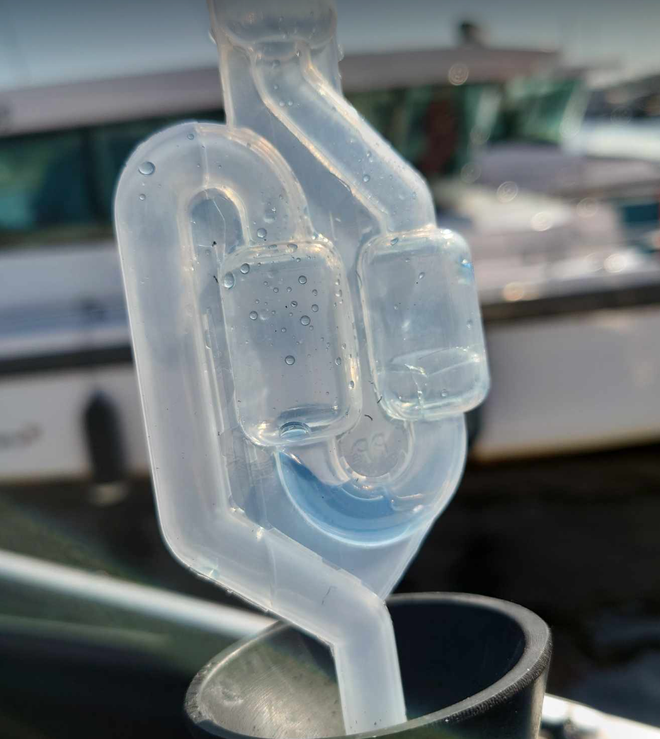

I tried to do an automotive CO2 test, where gasses from exhaust go through a dyed liquid that changes color, no result.
Since raw water cooling does not have an expansion tank, so I could not accumulate the gasses - so I tried just by making a tee between thermostat housing and manifold with a hose high enough so that water would not arise to the top and put the tester on top of it. Air bubbled through the test kit, but it did not change color.
I am not entirely sure if an automotive test could be applied to this situation. Does anyone have any idea or experience?
