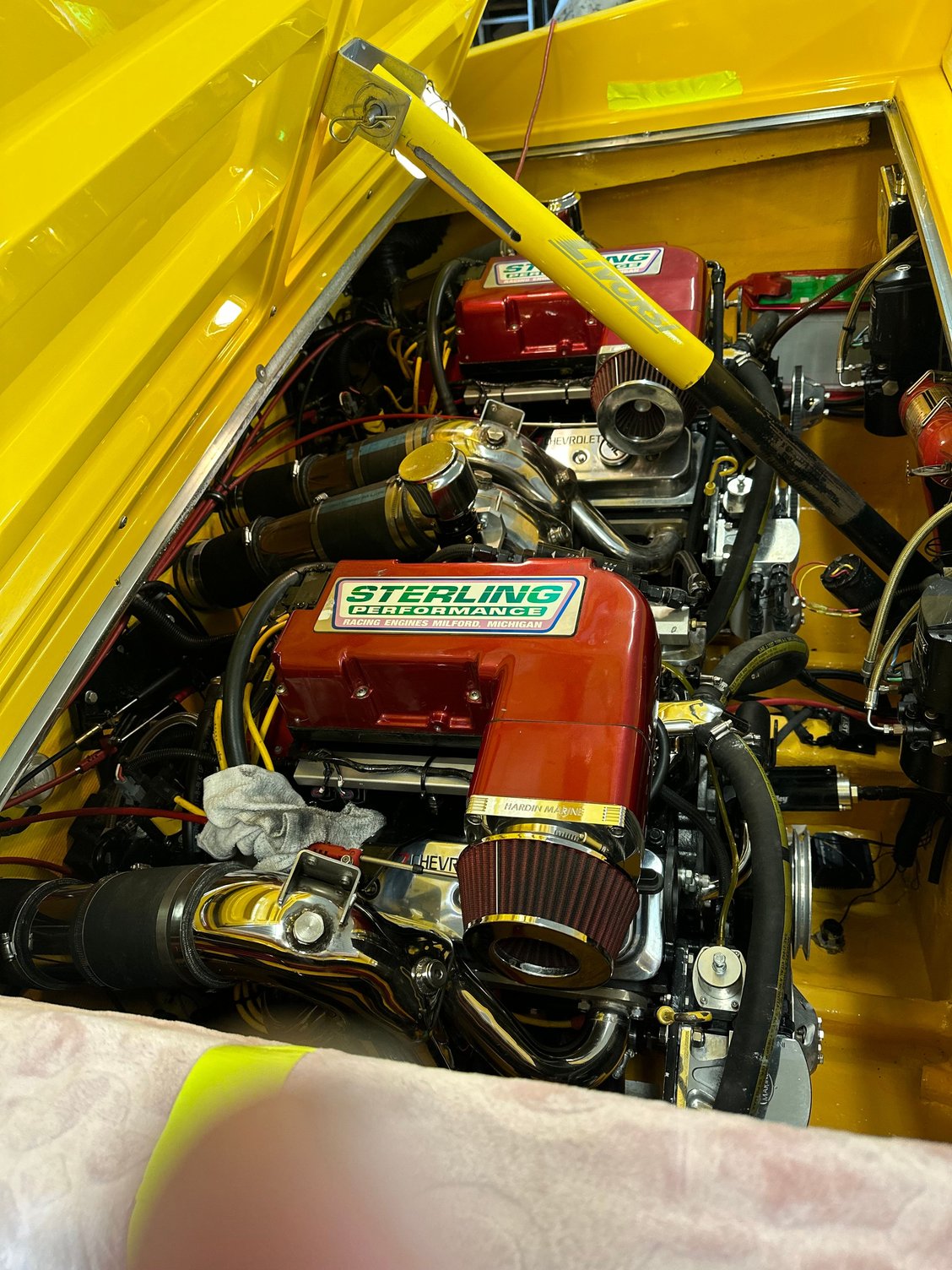

Originally Posted by sutphen 30
are these fuel injected motors?and if so,,who's system
sterlings 425 horse apiece

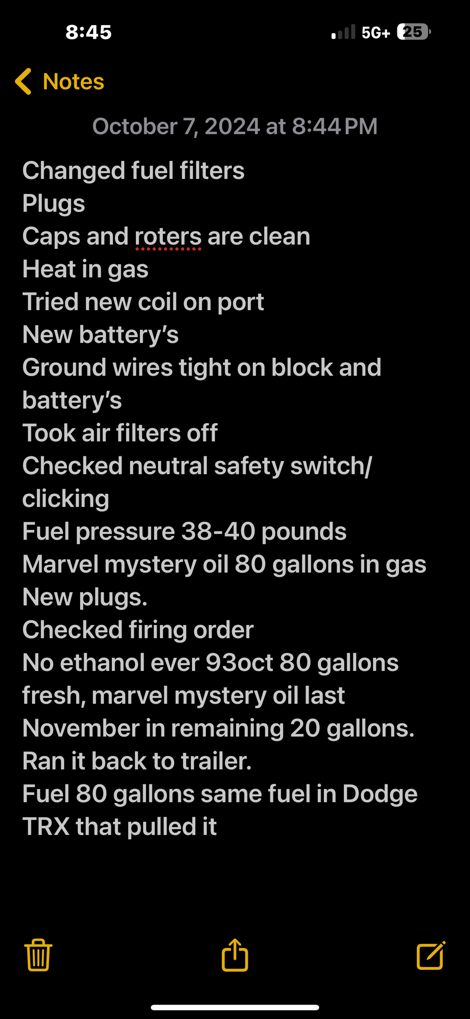

List to recap what has been done. Again it ran fine when I put it up last November. Just now getting it out and right off the trailer dealing with this idled it over to the lift thought it would be something simple. Frustrating
Classic description of water in your fuel caused by condensation in your fuel tank during long term storage. Water at the bottom of your tank will stay at the bottom. When you go to get on plane the water moves toward the rear of the tank where the pick up tubes are. Been there and done that first trip after a winter lay up. I think I dumped my water sep filter 4-5 times before it cleared out.
