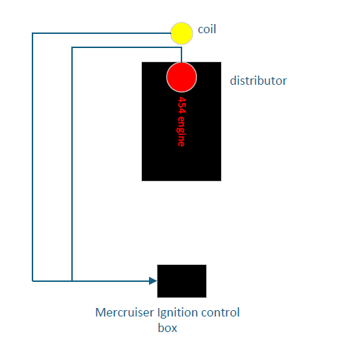

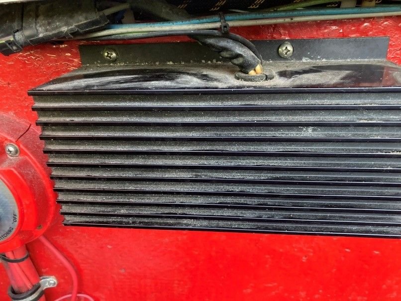

OLD mercruiser CDI ignition box connected to a T-Bolt distributor and a Nutek Sizzler coil. The ign box is mounted to the firewall, It is not the T-bolt style of control module or even the standard T-bolt style amplifier.
This is how I got the boat and it seemed to work before.
The port engine is the one that runs good and doesnt have issues. Per the manual the total timing is 28 deg and 16 inital, BUT that was when it had a points ignition. It now has the T-bolt dist body and a ign control box. I opened the sides of the ign box and see it is completely potted and does not have any adjustment pots of dip switches.
The port engine starts great and will idle well I can get the port to go into gear. In gear it will idle at 745 rpm at 14 deg of timing and 11 in HG vaccum. In neutral out of gear it will idle at 1100 rom 25 deg of timing and 14 in Hg vaccum. Why the timing moves around is beyond me for a box with no adjustments (unless its preprogramed and not adjustable)

The below picture is the ignition control box. There is no other module used
