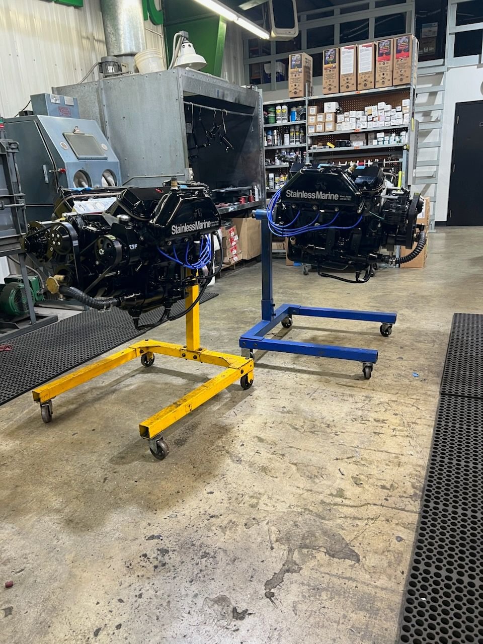

I recently converted my inboard from V-Belts to serpentine using these kits. Used crank mounted raw waterpump.
https://www.cvfracing.com/black-chev...7&gad_source=1
Top notch stuff.

Do you have a pic of your set up? That's a lot cheaper than the Hardin kit. (I know the Hardin kit comes with the sea water pump)
Did you get the alternator? I assume it's not rated for marine use?

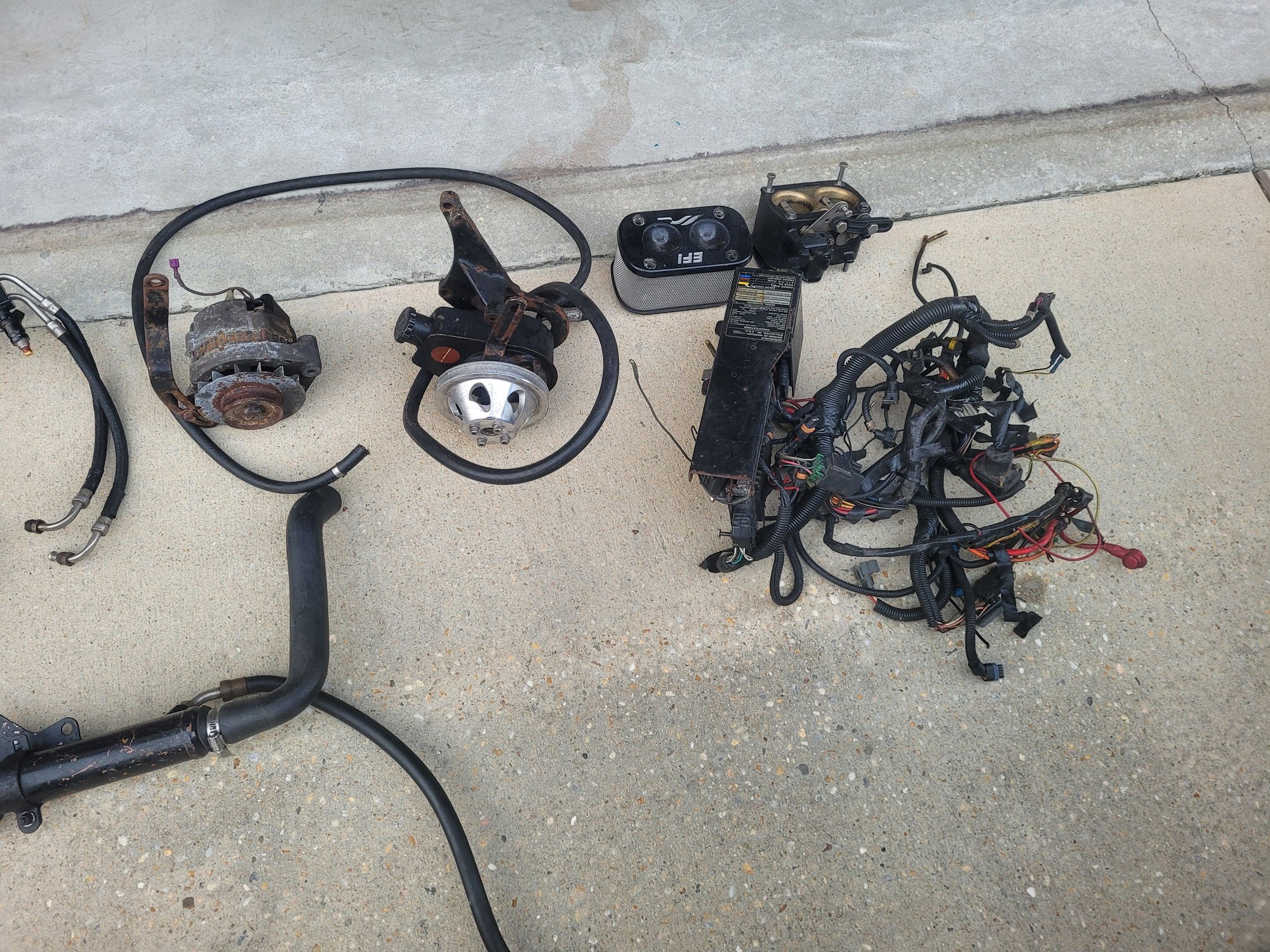

Does the engine still have the MPI stuff ?? I would be interested in the engine/EFI wire harness.

Hey Griff, I have the harness, fuel/ injector rail and an old distributor
Zoom in engine on left, you can see all accessories mounted up. Yes, I did source my own 100A Marine alternator. If your existing distrutor is a small cap HEI it will work
just fine for your carb set up.

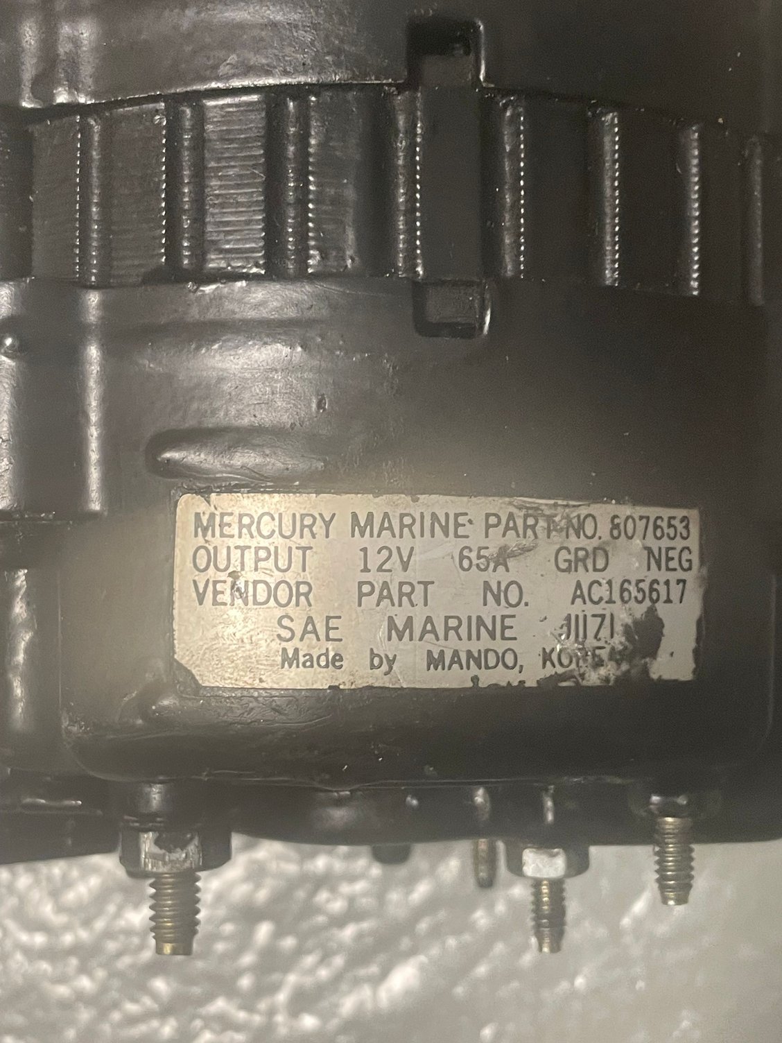

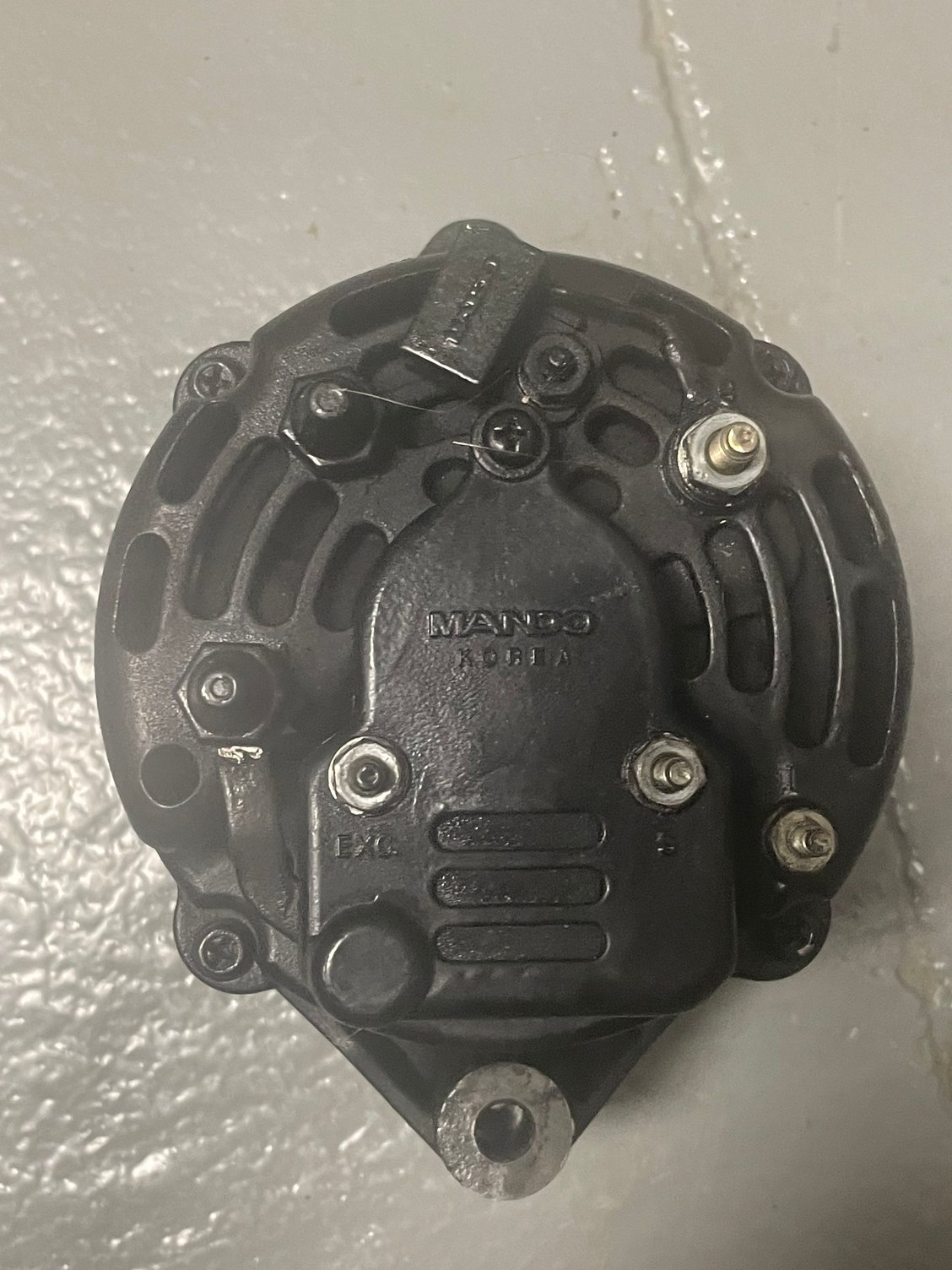

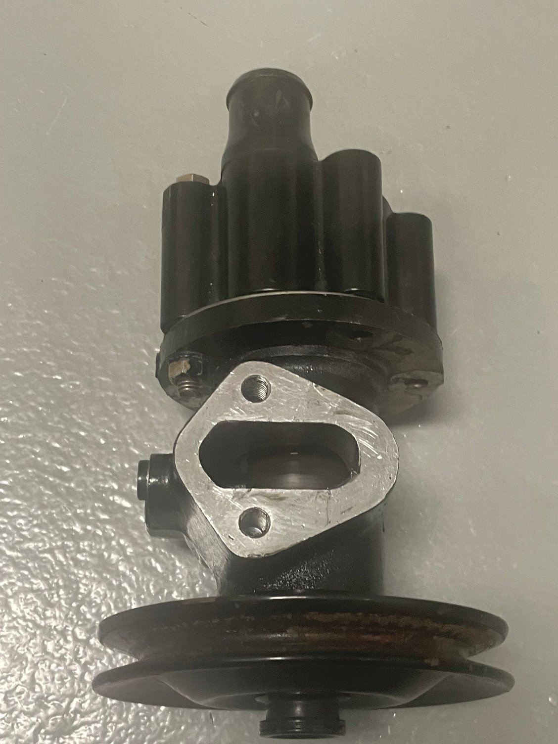

Thanks, but unfortunately that is for the earlier 502EFI engines that had the VST fuel system. I'm also pretty sure they were all Gen V blocks.
BTW, I do have a used Gen V seapump/fuel pump combo and a Merc alternator. Both with V belt pulleys. Came off a friends boat when he upgraded the hp and went with electric pumps. I would need to get alternator checked to verify its operational.

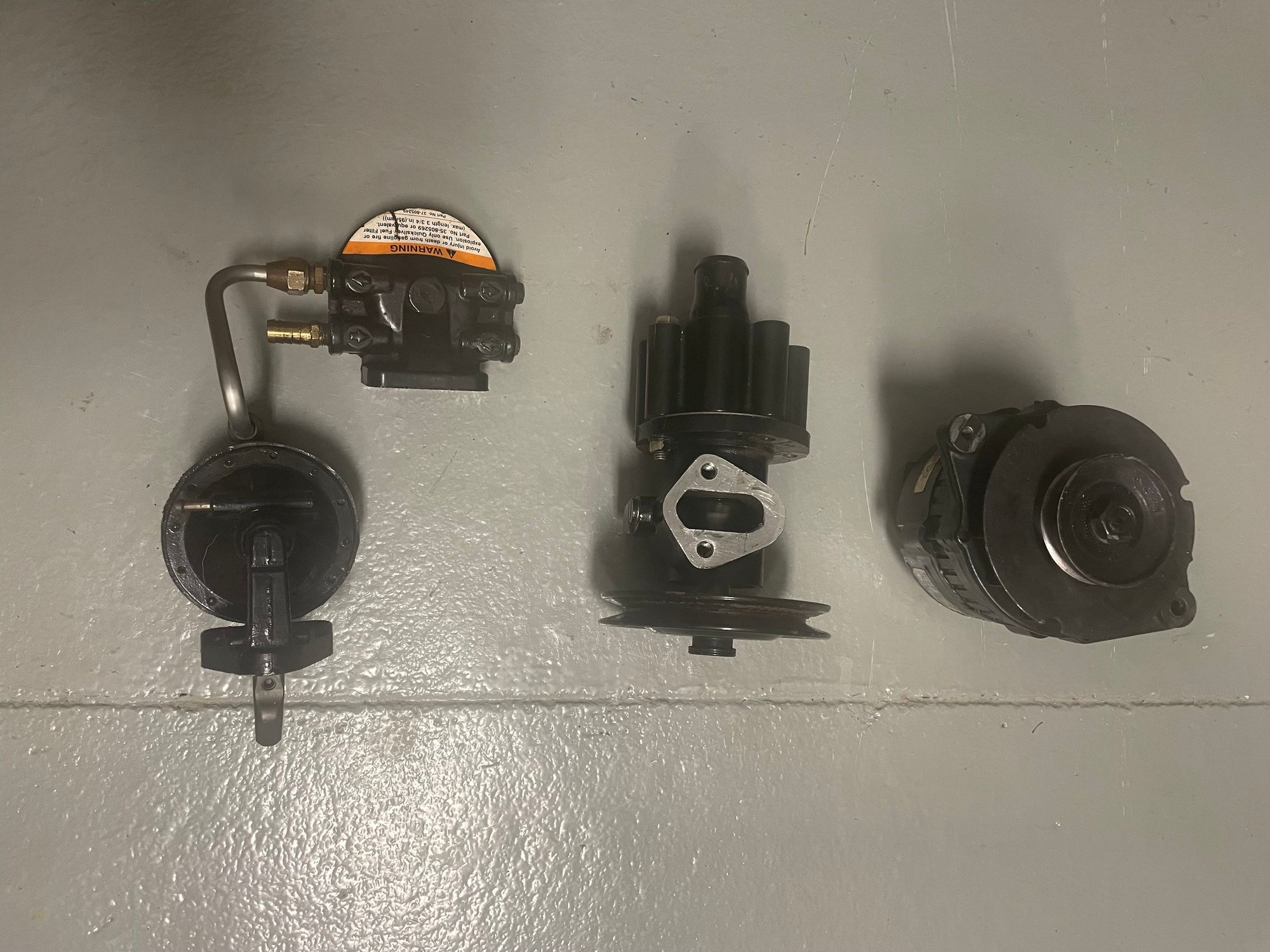

Steve do you have better pics of the raw water pump and part number? Johnson pump?
Thanks for the clarification GRIF - I'd be interested in pics and prices - I'm just trying to get the motor put back together before Spring/Summer -

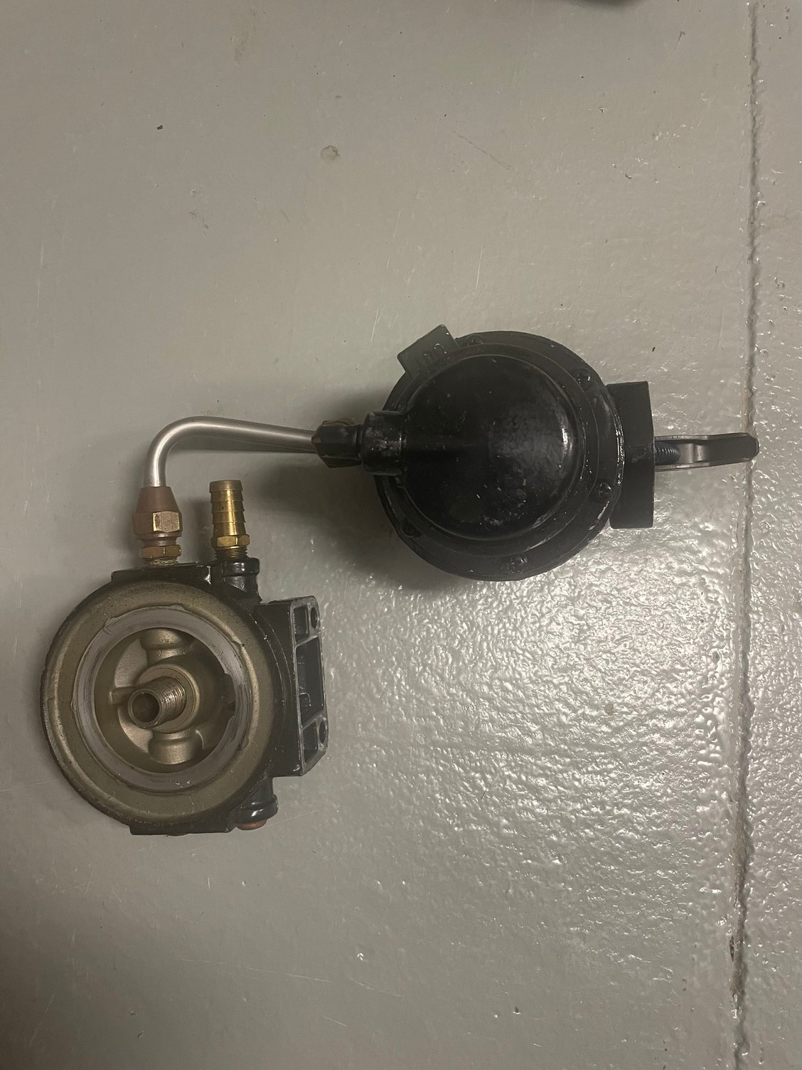

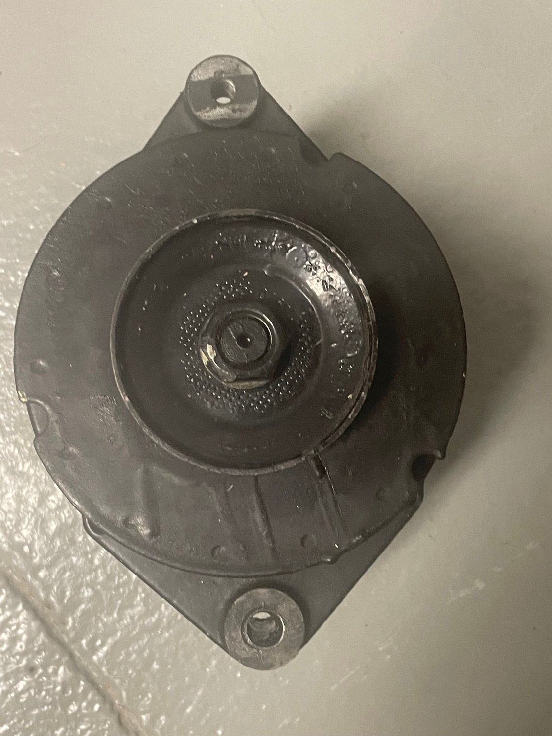

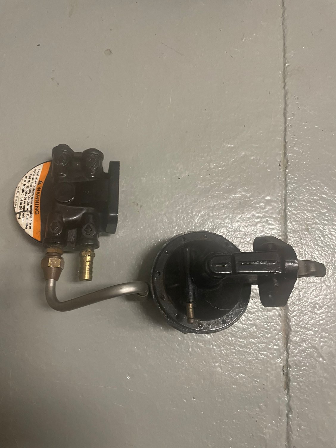

Here is what I have
Will need a new impeller kit
Mechanical fuel pump and water sep filter mount
