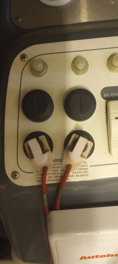

Leave the keys on and go to the fuse box in the boat usually in the cuddy but dont know what boat you have. Wiggle each fuse back and forth and up and down and see if you get alarm sound. If so pull fuse and replace . Before you insert new fuse slightly bend the spades. If its a no go flip the fuse 180 degrees and try again. Sometimes with that much power going through it sort of corrodes the receptacle so fiddling with the fuse is diagnostic
