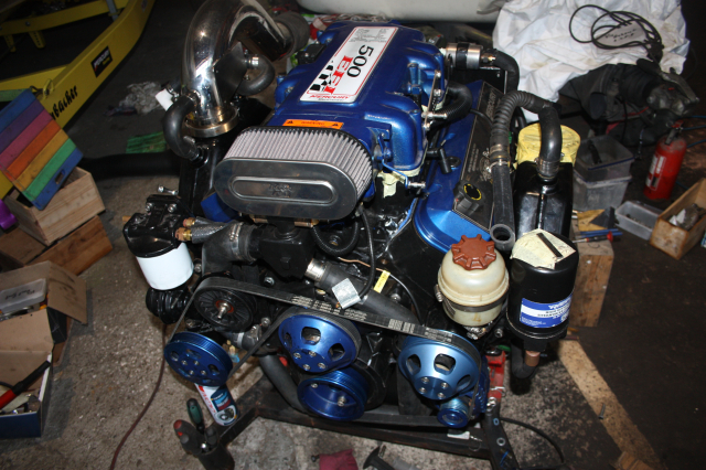

bajalux 05-03-2026 07:36 AM
Hi
Monday morning, we'll test the engine on the dyno
If it's OK, in the afternoon, the engine will be put back in its place in the Baja
https://si3.photorapide.com/invites/...5/03f08gl1.jpg
To be continued
hpmaniac 05-03-2026 12:53 PM
Make sure you tack welded the oil pump screen, locktite windage tray nuts, check cam endplay, between 3 and 8 thousands. If you have none you can remove some material from the cam thrust plate. On standard engine fastners if you ever are in question on torque values juat look up the bolt diameter. Like the cam plate bolts. Those need locktite as well.
