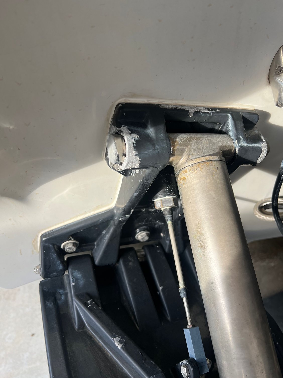

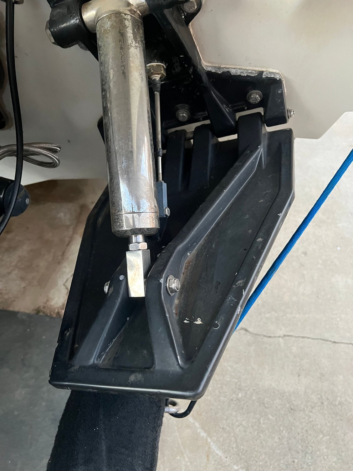

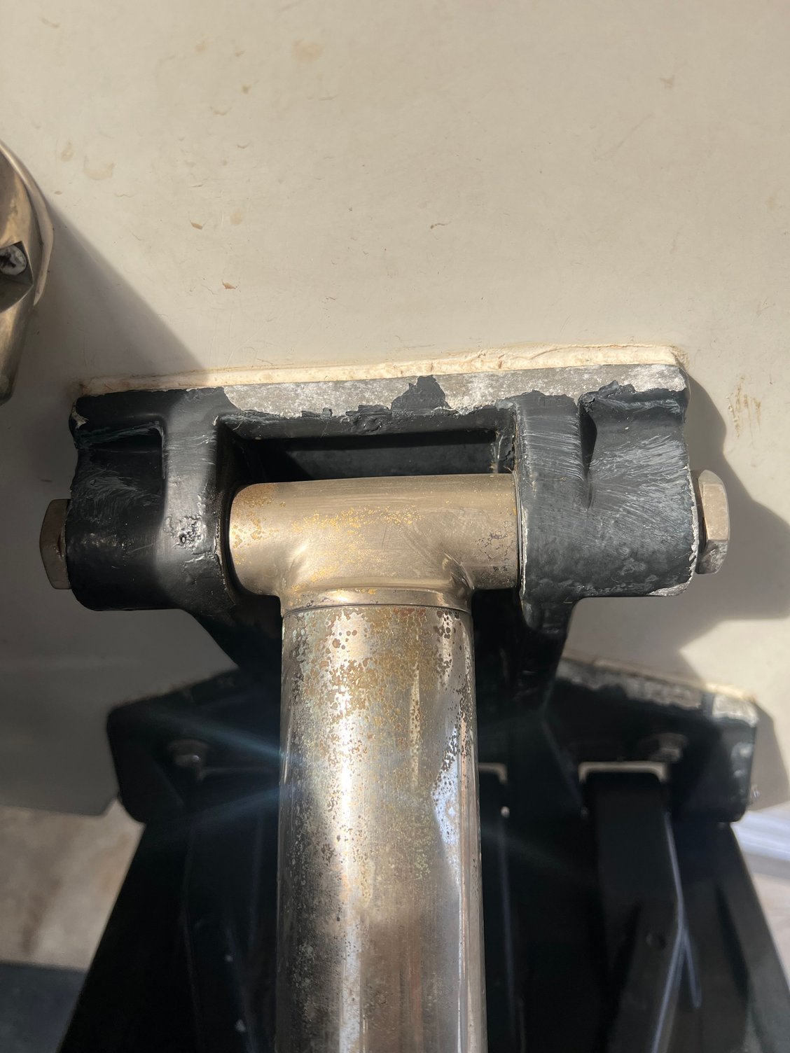

The trim tabs on my new boat are starting to peel. I’d like to remove them and have them hard anodized and then powder over the anodize.
however I’ve never had to unbolt any thing off a transom before and I’m unsure what I might be getting myself into.
There looks to be a bead of some kind of sealant running along edge of the trim tab mount on the transom. Is this how they are supposed to be sealed?
What is the proper way to seal them back up once I reinstall them?

It can depend on what and how much was used. 3M 4200 is meant to be removed at some point, 3M 5200 is not.
When I did mine I used long construction wood shims, a combination of putty knives/scrapers and trowel like spreaders. Visit Lowes or Home Depot and look around the concrete and drywall tools. Think chisel, something you can hammer on - stiff and thin - 1' to 2" wide worked the best. Avoid anything that isn't metal all the way through the handle. I hammered in the putty knife/scraper and then hammered in a wood shim next to it. Repeat in a different spot. On my boat, I believe someone had the tabs off and used 5200. It was spread on the tab mount like icing on a cake and I had to find tools that were long to get deep in between the two surfaces. Don't try to pry them off, it may pull the gel coat off. I taped around the the tab mount to prevent scratching the gel. There are scratches under the mount, but they are hidden by reinstallation. With the drives and other obstacles, angles for the hammer and chisel become tough.
3M makes a 5200 remover, but I didn't try it. I wasn't sure if it get in between the two surfaces.
Good luck
